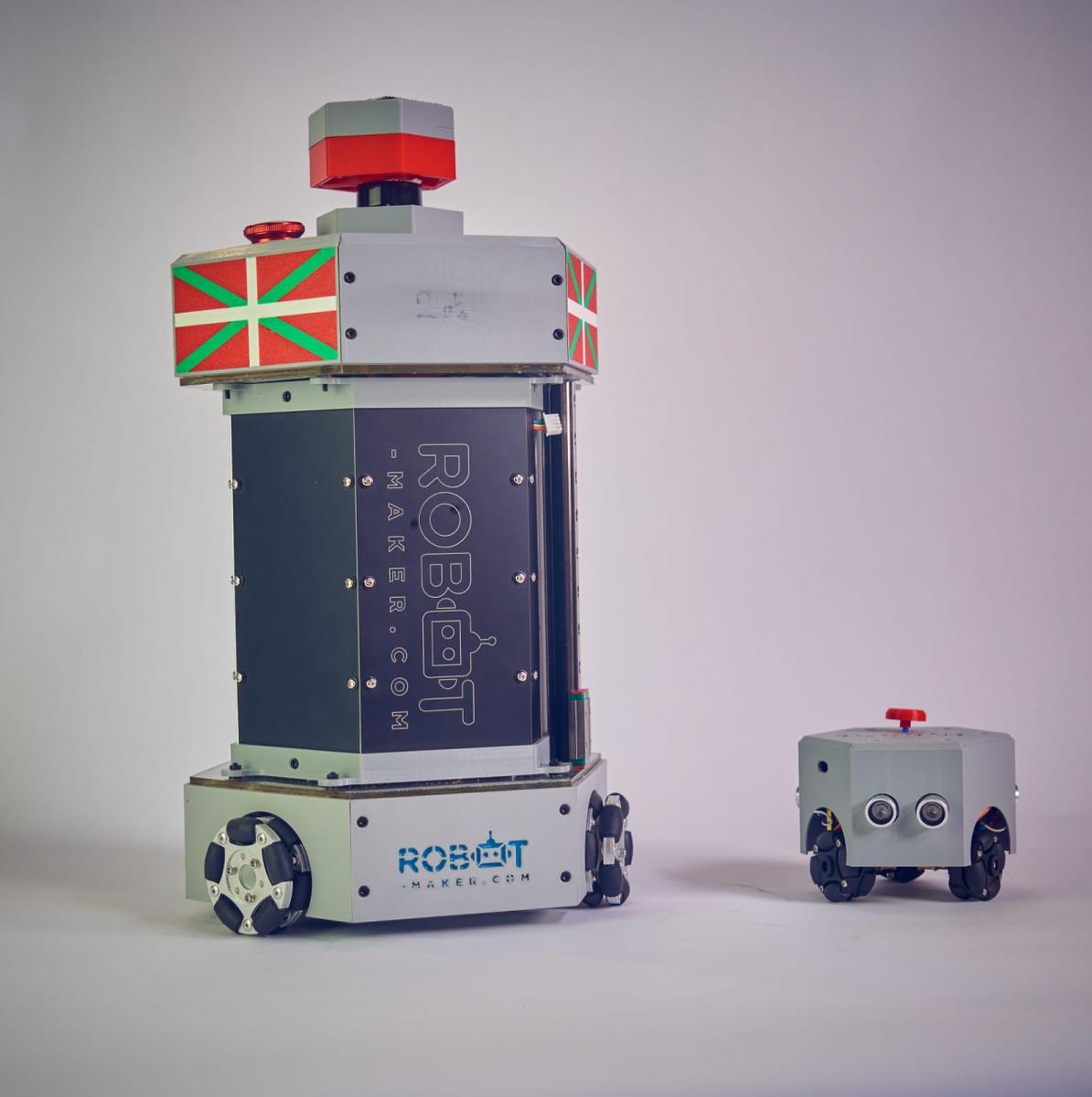

<br /><strong class='bbc'>Deux &#233;tages du robot principal termin&#233;s :</strong><br /><a class='resized_img' rel='lightbox[144]' id='ipb-attach-url-' href="https://www.robot-maker.com/forum/uploads/monthly_06_2025/blogentry-25113-0-39341000-1750279582.jpeg" title="WhatsApp Image 2025-06-18 at 22.36.17.jpeg - Taille : 60,66 Ko"><span rel='lightbox'><img class='bbc_img' itemprop="image" src="https://www.robot-maker.com/forum/uploads/monthly_06_2025/blogentry-25113-0-39341000-1750279582.jpeg" class='bbc_img linked-image' alt="WhatsApp Image 2025-06-18 at 22.36.17.jpeg" /></span></a>
<br /><strong class='bbc'>Le robot principal est fini !</strong> <em class='bbc'>(pour cette ann&#233;e)</em><br /><a class='resized_img' rel='lightbox[144]' id='ipb-attach-url-' href="https://www.robot-maker.com/forum/uploads/monthly_06_2025/blogentry-25113-0-74897700-1750279641.jpeg" title="WhatsApp Image 2025-06-18 at 22.36.19(2).jpeg - Taille : 65,03 Ko"><span rel='lightbox'><img class='bbc_img' itemprop="image" src="https://www.robot-maker.com/forum/uploads/monthly_06_2025/blogentry-25113-0-74897700-1750279641.jpeg" class='bbc_img linked-image' alt="WhatsApp Image 2025-06-18 at 22.36.19(2).jpeg" /></span></a>
<br /><strong class='bbc'>Merci aux sponsors :</strong><br />France Asia<br /><a class='resized_img' rel='lightbox[144]' id='ipb-attach-url-' href="https://www.robot-maker.com/forum/uploads/monthly_06_2025/blogentry-25113-0-54848500-1750279671.jpeg" title="WhatsApp Image 2025-06-18 at 22.36.19(3).jpeg - Taille : 72,51 Ko"><span rel='lightbox'><img class='bbc_img' itemprop="image" src="https://www.robot-maker.com/forum/uploads/monthly_06_2025/blogentry-25113-0-54848500-1750279671.jpeg" class='bbc_img linked-image' alt="WhatsApp Image 2025-06-18 at 22.36.19(3).jpeg" /></span></a>
<br />Robot-Maker<br /><a class='resized_img' rel='lightbox[144]' id='ipb-attach-url-' href="https://www.robot-maker.com/forum/uploads/monthly_06_2025/blogentry-25113-0-90399400-1750279695.jpeg" title="WhatsApp Image 2025-06-18 at 22.36.20.jpeg - Taille : 74,65 Ko"><span rel='lightbox'><img class='bbc_img' itemprop="image" src="https://www.robot-maker.com/forum/uploads/monthly_06_2025/blogentry-25113-0-90399400-1750279695.jpeg" class='bbc_img linked-image' alt="WhatsApp Image 2025-06-18 at 22.36.20.jpeg" /></span></a>
<br />&#160;	<span  style='color: #0000cd'>Bilan de cette &#233;dition</span><br />Pour cette ann&#233;e, le r&#233;sultat n'&#233;tait pas terrible : je n'ai pas eu le temps de terminer mon SLAM, point cl&#233; de ma localisation. Je faisais tout &#224; l'odom&#233;trie, mais comme je n'avais pas test&#233; le robot sur la surface de match, il glissait pas mal au d&#233;part. J'ai d&#251; corriger en g&#233;rant l'acc&#233;l&#233;ration du robot.<br />J'ai &#233;galement rencontr&#233; des probl&#232;mes classiques de pollution du lidar et un code d'&#233;vitement &#224; peaufiner sur la coupe. Bref, tous ces probl&#232;mes ont rendu mon s&#233;jour &#224; la Coupe de France de Robotique quelque peu mouvement&#233;.<br />J'ai tout de m&#234;me pass&#233; les homologations d&#232;s le premier jour (histoire de dire que mon robot n'&#233;tait pas totalement nul !). Mais niveau r&#233;sultats num&#233;riques, c'est pas &#231;a... mais alors pas &#231;a du tout : 3 points et quasiment dernier au classement.<br />Cependant, je ne participais pas &#224; la Coupe de France de Robotique pour faire de la comp&#233;tition pure, c'&#233;tait plut&#244;t pour me donner une &#233;ch&#233;ance avec pour objectif a minima un robot homologable et styl&#233;. &#192; ce titre : <span  style='color: #ff0000'><strong class='bbc'>objectif r&#233;ussi !</strong></span><br />&#160;	<span  style='color: #0000cd'>Description de l'architecture logicielle</span><br />Premier &#233;tage : dot&#233; d'une Raspberry Pi Pico qui g&#232;re l'asservissement et fait un retour de position gr&#226;ce &#224; l'odom&#233;trie. De plus, elle g&#232;re un LD06 et fait une grid map. Cette derni&#232;re n'est pas utilis&#233;e pour le moment car j'avais plus urgent.<br />Troisi&#232;me &#233;tage : on retrouve une Raspberry Pi Pico W munie d'un lidar pour la d&#233;tection de robots adverses. Elle g&#232;re les waypoints envoy&#233;s &#224; la Raspberry Pi pico du bas via une communication UART. De plus, elle communique via WiFi avec le petit robot qui lui aussi est dot&#233; d'une Raspberry Pi Pico W.<br />Interface utilisateur : le troisi&#232;me &#233;tage dispose d'une Raspberry Pi 4 avec &#233;cran pour faire une interface utilisateur que j'ai commenc&#233; &#224; d&#233;velopper en Java.<br />J'ai programm&#233; mes Pico avec l'IDE Arduino, et si j'ai r&#233;ussi &#224; tenir une odom&#233;trie &#224; 60 000 tics par tour &#224; 1,2 m/s, c'est gr&#226;ce &#224; la programmation des modules PIO. Il faudra que je vous fasse un tutoriel pour pouvoir le reproduire sur Arduino.<br />&#160;	<span  style='color: #0000cd'>Perspectives d'am&#233;lioration</span><br />&#201;videmment, terminer le travail commenc&#233; et le peaufiner. J'aimerais int&#233;grer des applications d'intelligence artificielle dans mon robot, notamment gr&#226;ce &#224; la nouvelle carte RDK de chez D-Robotics.<br />Il faut aussi que j'am&#233;liore le hardware de mon robot avec des PCB customis&#233;s partout !<br />Enfin, si vous avez d'autres id&#233;es, je suis preneur : j'adore d&#233;couvrir de nouvelles choses.<br />&#160;<br />J'esp&#232;re donner des nouvelles prochainement sur les am&#233;liorations apport&#233;es au logiciel, et d'ici l&#224;, je vous invite &#224; laisser des commentaires et &#224; partager vous aussi vos projets !<br />&#160;<br />&#160;<div id='attach_wrap' class='rounded clearfix'>

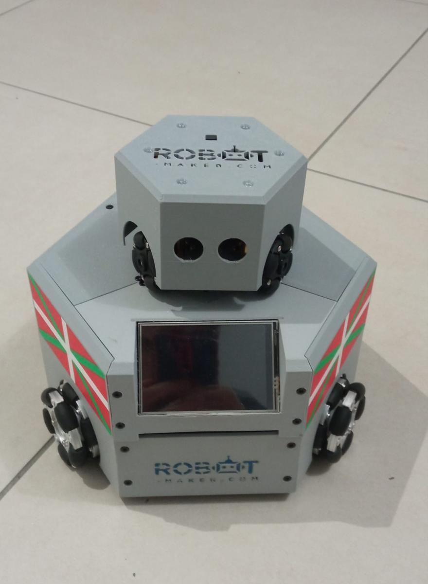

		<description><![CDATA[<strong class='bbc'>Bonjour &#224; tous,</strong><br />Je suis heureux de vous annoncer que j'ai enfin termin&#233; le troisi&#232;me &#233;tage de mon robot !<br />&#192; court terme, il devra int&#233;grer les fonctionnalit&#233;s suivantes :<ul class='bbc'><li>Un arr&#234;t d'urgence.</li><li>Un d&#233;marrage &#224; distance.</li><li>Une interface interactive pour communiquer avec le robot.</li><li>Une communication bidirectionnelle avec les &#233;tages inf&#233;rieurs.</li><li>Le calcul de trajectoires.</li></ul><a class='resized_img' rel='lightbox[141]' id='ipb-attach-url-' href="https://www.robot-maker.com/forum/uploads/monthly_02_2025/blogentry-25113-0-15379700-1740521116.png" title="blog.png - Taille : 147,59 Ko"><span rel='lightbox'><img class='bbc_img' itemprop="image" src="https://www.robot-maker.com/forum/uploads/monthly_02_2025/blogentry-25113-0-15379700-1740521116.png" class='bbc_img linked-image' alt="blog.png" /></span></a>
<br />&#160;<br />Voici une photo des deux &#233;tages empil&#233;s. J'ai r&#233;alis&#233; des impressions multicolores pour les drapeaux basques, ce qui &#233;tait tr&#232;s int&#233;ressant &#224; faire. En plus, j'ai pens&#233; essayer d'ajouter de la r&#233;sine &#233;poxy dans les logos.<br />Un conseil si, un jour, vous voulez vous lancer dans ce genre de projet : m&#233;langez bien les composants A et B avant d'appliquer la r&#233;sine dans le logo. Utilisez une seringue pour plus de pr&#233;cision. Et surtout, lorsque vous passez un briquet pour faire &#233;clater les bulles d'air, faites attention &#224; ne pas faire fondre le plastique. Passez rapidement la flamme sans insister.<br />Si vous avez des questions/ recommandations n&#8217;h&#233;sitez pas je suis preneur !<br />&#224; tr&#232;s vite pour vous montrer le r&#233;sultat de fabrication...<br />&#160;<div id='attach_wrap' class='rounded clearfix'>
