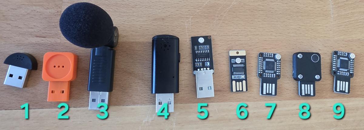

Hello i tested multiple microphones and complied it into a video:
Mic_test.mp4   137,15 Mo
The microphones:
1) cheap generic black mini mic from china ~1$
2) Orange-AI mic ~9$
3) BOYA BY-M100 21$
4) ?
5) ?
6) ?
7) robot-maker mic v1
8) robot-maker mic v2
9) robot-maker mic v1
The amplification gains used were [dB]:
+40 +36 +31 +6 +37 +29 +57 +13 +55

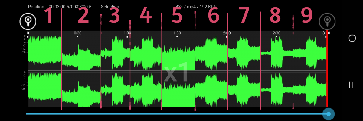

The primary metric by which i'd judge them, is how quiet the silent periods are.
The results:
In my opinion, the best microphone is:
#8 robot-maker mic v2.
Also good are:
#2, #3 and #7/#9, although the #7/#9 are very quiet.
Interestingly, #4, while it was the loudest out of the box, has a non-stop loud buzzing noise.
Result frame used in the video:mic_test_20260924102531.png
