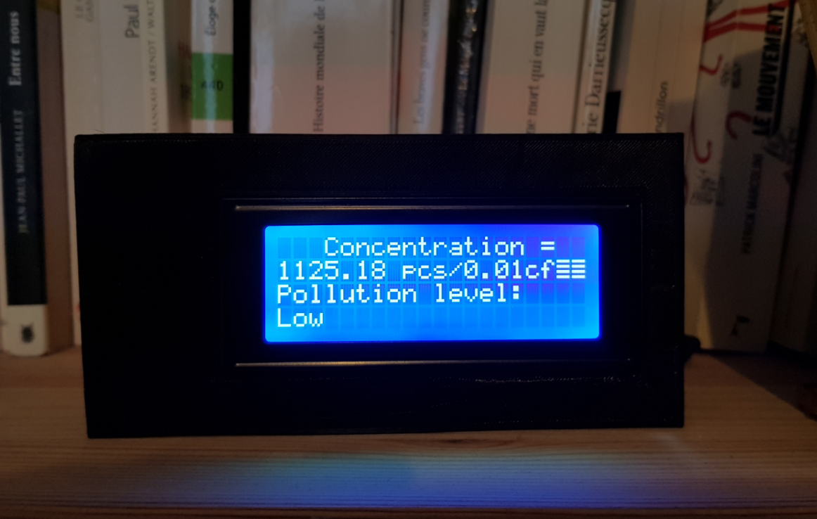

Bonsoir,
j'ai besoin de votre aide car mon code ne fonctionne pas.
J'ai l'impression qu'il ne sort jamais de la suite de boucle if (la valeur ne descend jamais, elle est en constante augmentation)
#include <Wire.h>
#include <LiquidCrystal_I2C.h>
LiquidCrystal_I2C lcd(0x27,20,4);  // set the LCD address to 0x27 for a 16 chars and 2 line display
int pin = 8;
unsigned long duration;
unsigned long starttime;
unsigned long sampletime_ms = 30000;//sampe 30s ;
unsigned long lowpulseoccupancy = 0;
float ratio = 0;
float concentration = 0;
float concentrationbefore = 0;
void setup() {
 Serial.begin(9600);
 pinMode(8,INPUT);
 starttime = millis();//get the current time;
 lcd.init();                      // initialize the lcd
  lcd.init();
  // Print a message to the LCD.
 lcd.backlight();
void loop() {
 duration = pulseIn(pin, LOW);
 lowpulseoccupancy = lowpulseoccupancy+duration;
 if ((millis()-starttime) > sampletime_ms)//if the sampel time == 30s
 ratio = lowpulseoccupancy/(sampletime_ms*10.0); // Integer percentage 0=>100
 concentration = 1.1*pow(ratio,3)-3.8*pow(ratio,2)+520*ratio+0.62; // using spec sheet curve
 lcd.setCursor(0,0);
 lcd.print("   Concentration = ");
 lcd.setCursor(0,1);
 lcd.print(concentration);
 lcd.println(" pcs/0.01cf");
 lcd.setCursor(0,2);
 lcd.print("Pollution level:");
 lcd.setCursor(0,3);
 lcd.print("                     ");
   if(concentration < 400)
   lcd.setCursor(0,3);
   lcd.print("                     ");
   lcd.setCursor(0,3);
   lcd.print("NO");
   if(concentration > 400)
   lcd.setCursor(0,3);
   lcd.print("                     ");
   lcd.setCursor(0,3);
   lcd.print("Very Low");
   if(concentration > 800)
   lcd.setCursor(0,3);
   lcd.print("                     ");
   lcd.setCursor(0,3);
   lcd.print("Low");
   if(concentration > 1500)
   lcd.setCursor(0,3);
   lcd.print("                     ");
   lcd.setCursor(0,3);
   lcd.print("Medium");
   if(concentration > 2500)
   lcd.setCursor(0,3);
   lcd.print("                     ");
   lcd.setCursor(0,3);
   lcd.print("Very High");
une idée ?
Ca donne ca sinon:

#37 Mike118
  • 10 955 messages
Posté 26 février 2020 - 12:34
Bonsoir,
#include <Wire.h>
int pin = 8;
float ratio = 0;
void setup() {
 Serial.begin(9600);
 pinMode(8,INPUT);
  lcd.init();
 lcd.backlight();
void loop() {
 lcd.setCursor(0,0);
 lcd.setCursor(0,1);
 lcd.setCursor(0,2);
 lcd.setCursor(0,3);
 lcd.print("                     ");
   lcd.setCursor(0,3);
   lcd.print("                     ");
   lcd.setCursor(0,3);
   lcd.print("NO");
   lcd.setCursor(0,3);
   lcd.print("                     ");
   lcd.setCursor(0,3);
   lcd.setCursor(0,3);
   lcd.print("                     ");
   lcd.setCursor(0,3);
   lcd.print("Low");
   lcd.setCursor(0,3);
   lcd.print("                     ");
   lcd.setCursor(0,3);
   lcd.setCursor(0,3);
   lcd.print("                     ");
   lcd.setCursor(0,3);
une idée ?
Ca donne ca sinon:
Pas sur que ça résolve ton problème car j'ai pas compris le problème que tu rencontres mais je pense que tu as oublié d'incrémenter starttime quand tu rentres dans le if ...
 starttime += sampletime_ms;
 // ajouter le reste du code ...

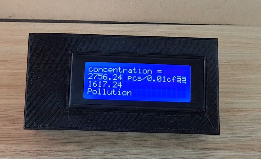

#38 Larti
Larti
  • 163 messages
Posté 13 mars 2020 - 10:13
Hello,
Effectivement, par mégarde j'avais supprimé le starttime !
Ça marche plutôt bien. Par contre je suis déçus par la date la puissance de l'accu qui se décharge au bout de 40mn.
c'est celui la : https://www.robot-ma...geable-207.html
Est ce que vous pensez que je peux brancher une power bank qui sert à recharger les portables sur l'accu et l'accu alors que l'accu serait brancher à l'Arduino?
Autre question, est-ce que vous savez si il existe des câbles permettant de se brancher à la fiche de l'arduino d'un coté est avec un USB femelle de l'autre? Cela me permettrait de brancher directement le power bank sur l'arduino.
Sinon voici ce que ca donne :

#39 Sandro
Sandro
  • 1 354 messages
Posté 13 mars 2020 - 10:28
Ce que tu peux faire facilement, c'est de brancher ton powerbank (via cable USB) sur le port USB de l'arduino (celui qui sert à la programmation). Tu peux alors retirer ta batterie pour la recharger.
Brancher une batterie de secours de portable (5V) directement sur la prise d'alimentation ronde (le gros "jack"), ne fonctionnera pas : sur cette prise, il faut au moins 7V (6V peut suffire mais avec des risques d'instabilité). Pour utiliser du 5V, soit tu passes par le port USB, soit tu le mets directement sur le pin "5V" de l'arduino.
Bonne journée
