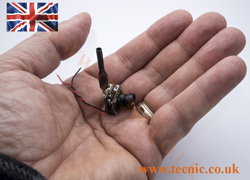

I understand, but look this :
#323 Serveurperso
Serveurperso
  • 3 428 messages
Posté 26 avril 2020 - 07:33
fucking tiny !
way smaller than a PI zero !!!
and high quality wide angle picture and better sensitivity than our PI camera !
there is a lot of model and very cheap <15$

Yes camera is cheap and small but what hardware should we add to have them working on vigibot ? And what latency would we get?
#325 Serveurperso
Serveurperso
  • 3 428 messages
Posté 26 avril 2020 - 07:37
expensive and like radiobot
but after the ground station, each robot cost cheaper than Minus !
robot = arduino + RF receiver + this camera
and you get a (bit) better range than wifi
One robot on vigibit with data broadcast to all robot, and multiple camera selector
this is a new way for research : a 5.8GHz RF video receiver with integrated capture & TBC working on a PI 4

i use those fpv cameras on my multicopters :)
so i couldn't just use a cheap 5.8G downlink receiver connected to a easyCAP usb adaptor?

easyCAP is Time base sensitive, the driver kernel module crash when there is RF noise
#328 firened
firened
  • 1 783 messages
Posté 26 avril 2020 - 07:44
i only have fpv goggles with video out. but a simple video receiver can be very cheap ~30$

try for reliability at maximum range
just launch capture on a Linux computer, go out of range / in range / out of range -> crash
if there is no crash -> this is a new solution for vigibot

but for deinterlace a computer is better, the PI 4 is overloaded
there is hardware deinterlacer like I use on my "Astro" robot with the B/W sensitive camera
I must try the reliability with this one. Cost about 150$ for the capture card. This is not a EasyCAP clone
I don't know if there is an time base correction inside it
A TCB add 1/2 frames more latency....

there's also 5.8G USB receivers for android phones. you think they'd be different and not crash a pi?

Posté 26 avril 2020 - 07:48
EasyCAP....
you must test....
A one day testing @ maximum range is good
I do this EasyCAP test on the old-old stable Linux Jessie
Now we must test the Buster driver...
no crash -> I can vigibot it
Put it on a PI 4 and I configure for video....
