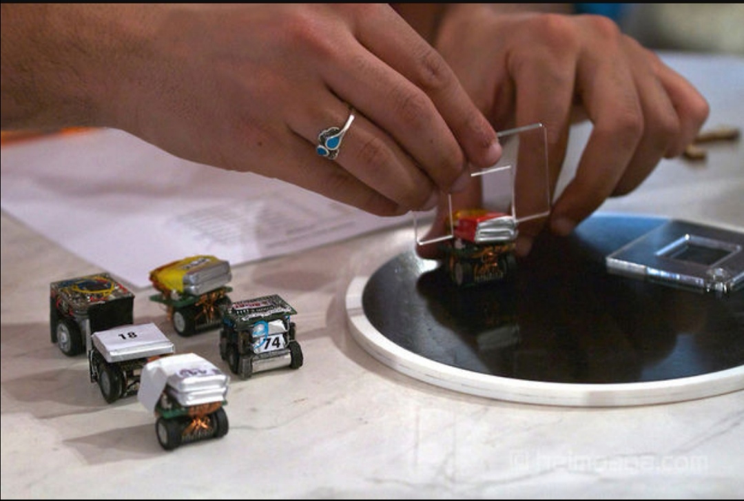

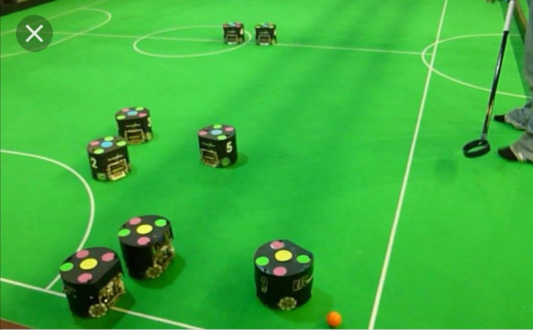

8. a quiz. there's 3 fields on the floor. a question gets displayed with 3 answers. players move their tiny robot onto the field they think is correct. like the "1, 2 or 3" tv show from 15 years ago. (position can get determined by using pulsed lights on each field)
example photos:
5. with tiny bots:
7. with tiny bots:
