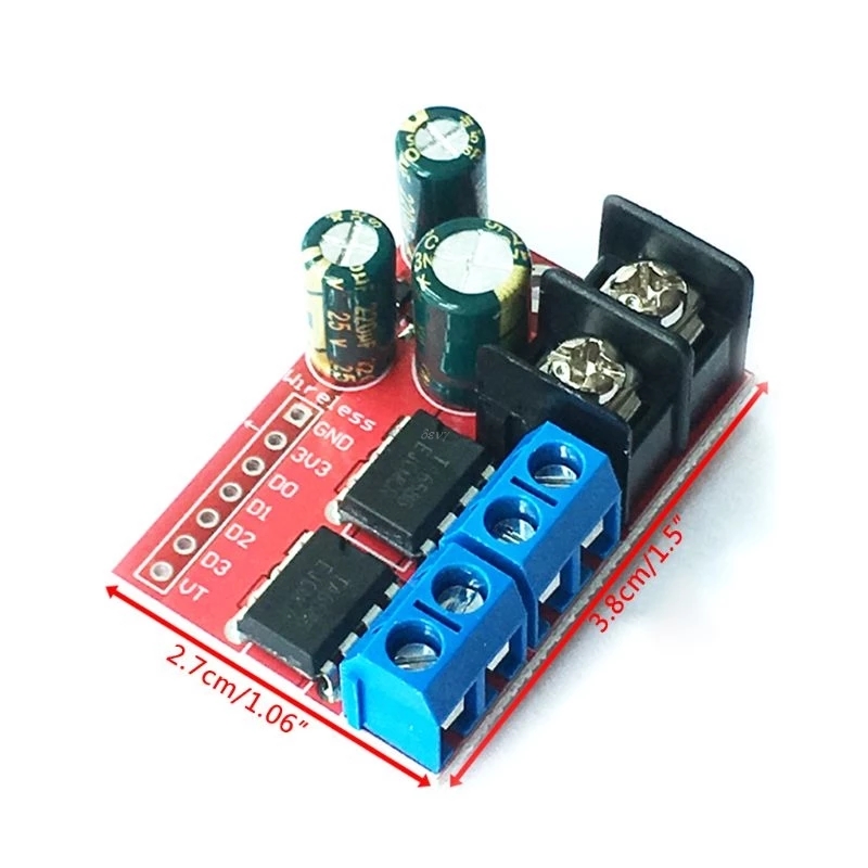

and this one is better than a simple transistor because you can reverse the sens
( while you can't with just only one transistor )

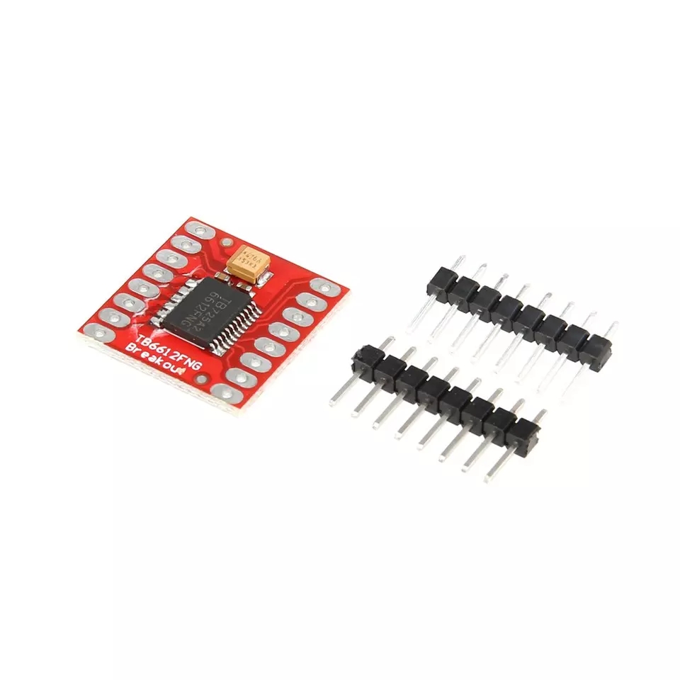

@Deleted User you should use one of these versions they have a much better performance and have a brake mode ;) -1761939174-1819870882.jpg

The first is TB6612FNG and the second is named " super l298 "

TB6612FNG is a super super l298

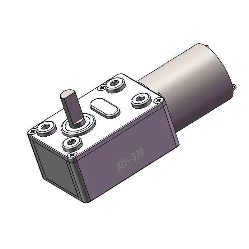

Ce genre là style moteur de store c'est pas mal pour les grandes inerties 779919445-1635221002.jpg

Oui ceux en photo peuvent aller. Prend moins de 100rpm genre 70/80 ça ira pour 17cm
