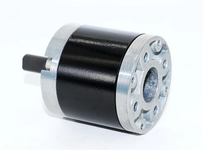

Posté 07 juillet 2022 - 03:29
a gearbox for this motor could work
#73 firened
firened
  • 1 782 messages
this is the only one i find on amazon and it's overpriced
https://www.amazon.c...,aps,278&sr=8-3
meanwhile on ali
https://a.aliexpress.com/_uyUuvo
#74 OdorousWo1f
OdorousWo1f
  • 1 154 messages
Posté 07 juillet 2022 - 03:32
yeah that seems very overpriced. that thing seems massive
wow that is cheap. i HATE buying stuff off of ali but i might make this as an exception. have you used aliexpress regularly before? is it safe to use?
or is it just like ebay where people can list stuff except here it's companies selling their stuff.
wait is this one just a gearbox w/ no motor?
#75 firened
firened
  • 1 782 messages
Posté 07 juillet 2022 - 03:42
it's ok.
value is really good but there's crap too sometimes.
yes exactly
#76 OdorousWo1f
OdorousWo1f
  • 1 154 messages
Posté 07 juillet 2022 - 03:43
ah
so our 775 3 billion RPM motor attaches to the back of that and then boom. looks massive for a 775 though.
#77 OdorousWo1f
OdorousWo1f
  • 1 154 messages
Posté 07 juillet 2022 - 03:44
am i using these?
#78 firened
firened
  • 1 782 messages
Posté 07 juillet 2022 - 03:45
yes that's the plan so far.
4x those Amazon motors
and 4x gearboxes
