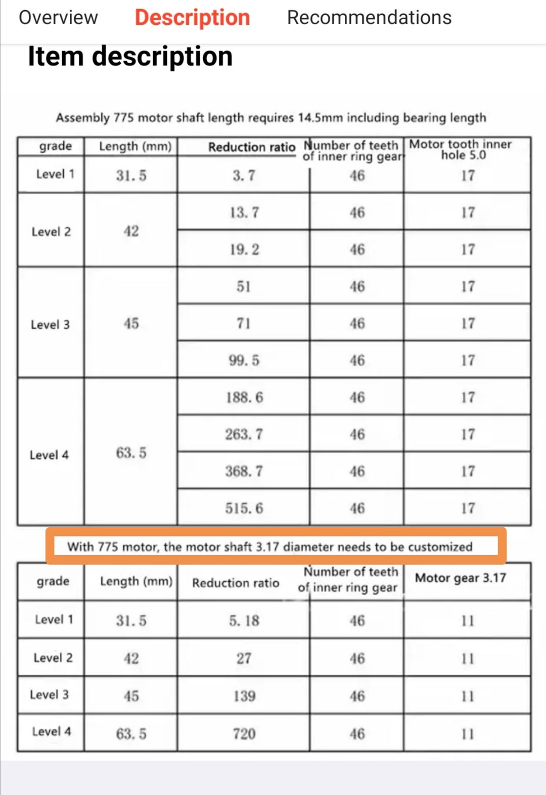

wait a second
how does the motor attach to the gearbox
or rather the shaft to the gearbox itself
#82 firened
firened
  • 1 782 messages
Posté 07 juillet 2022 - 03:49
open the gearbox and screw the outermost static gear onto motor.
hope that the pinion fits. the bearbox has apparently options for 5mm and 3.75mm or something or is that the output
probably hope it fits, hope all 775 motors are the same idk

what does it mean "customized"
like you need to do something yourself?
#85 firened
firened
  • 1 782 messages
Posté 07 juillet 2022 - 03:58
idk what it means :/

Posté 07 juillet 2022 - 04:07
their google translate was probably down
#87 firened
firened
  • 1 782 messages
Posté 07 juillet 2022 - 04:09
looks like the pinion is industrially pressed onto the shaft, there's no filled off side https://m.youtube.co...h?v=B95DfQ9JX_o
#88 OdorousWo1f
OdorousWo1f
  • 1 154 messages
Posté 07 juillet 2022 - 04:10
hmm
so i guess we gotta hope it works or find a different one.
#89 firened
firened
  • 1 782 messages
Posté 07 juillet 2022 - 04:12
maybe ask the ali seller and send them the Amazon motor link.
#90 OdorousWo1f
OdorousWo1f
  • 1 154 messages
could do that too
