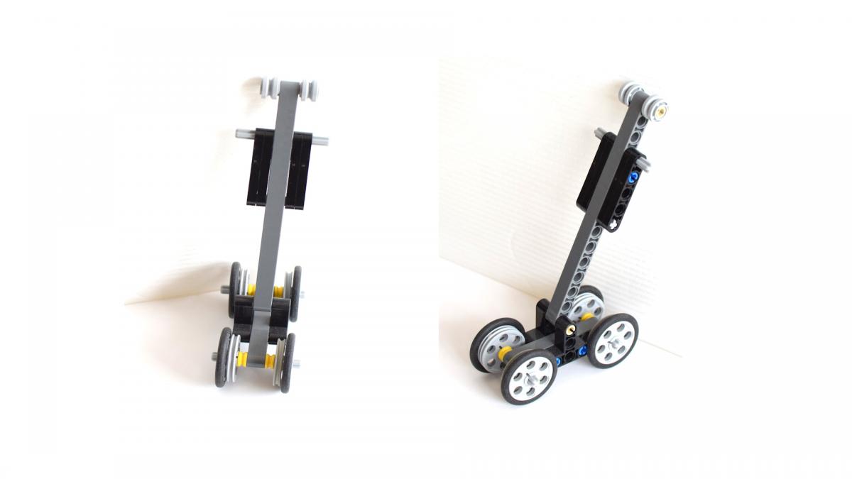

#48 Oracid
Posté 01 mars 2024 - 02:55
Please, always give the references.
- Sorry the part A in image 2 are 42610 not 56902.
- No, the belt 2815 goes only with the wheel 4185.
- yes, in image 2, between  the 2 wheels 4185, there is 2 bushes 3713.
Here is the trolley with his arm. If you don't find the references of parts on Bricklink, please ask.
Please click on me.

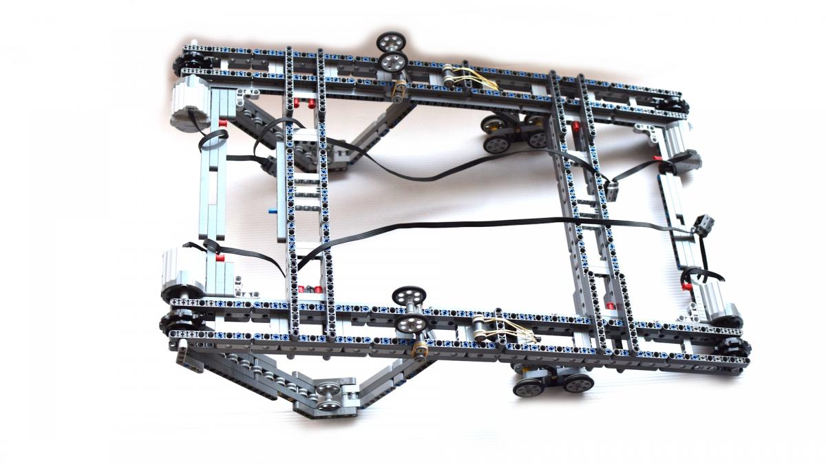

#49 PeterC
PeterC
  • 12 messages
Posté 01 mars 2024 - 09:00
Two more things, if I may:
Images 5 & 6: Image 5.png Image 6.png
I don't see any connections between the beam (5A) and the upper beams of the frame or the beams at 6A. I can only assume that they are there and I don't see them.
Also, of the 2 wheels 42610 in Image 1 are not connected by the belt 2815, what are you using?
Thanks again.

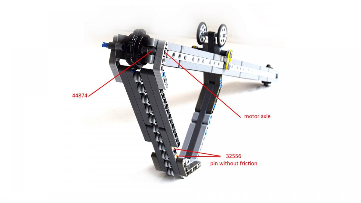

#51 Oracid
Posté 02 mars 2024 - 07:49
One more thing: do you know how many tread pieces were used?
The 42610 wheels are very cheap. You need about 35, but you can buy 100.
Here is an image with some details.
Click on me.
Don't hesitate to ask.

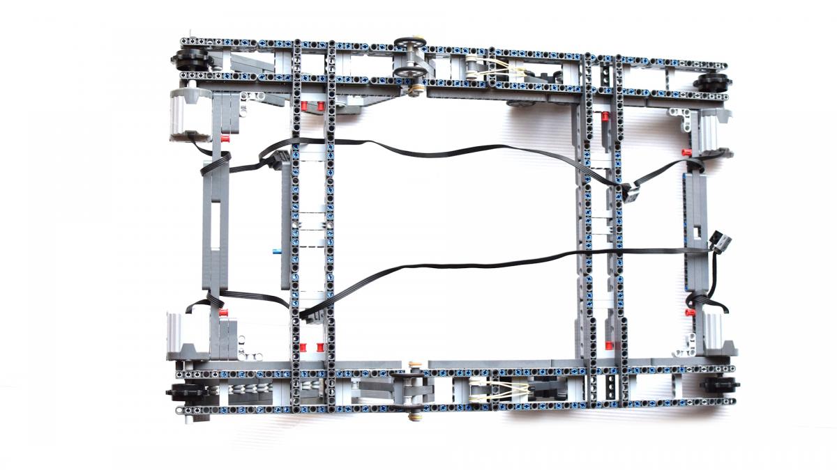

OK, all I think I need now is a top-down picture of the whole thing without the tracks on.
#59 Oracid
Posté 05 mars 2024 - 08:28
Click on me.
Click on me.
