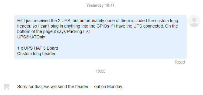

Thanks, but I already ordered 4 pieces from a local shop, they arrive on monday.

The seller responded, they should've included the risers.

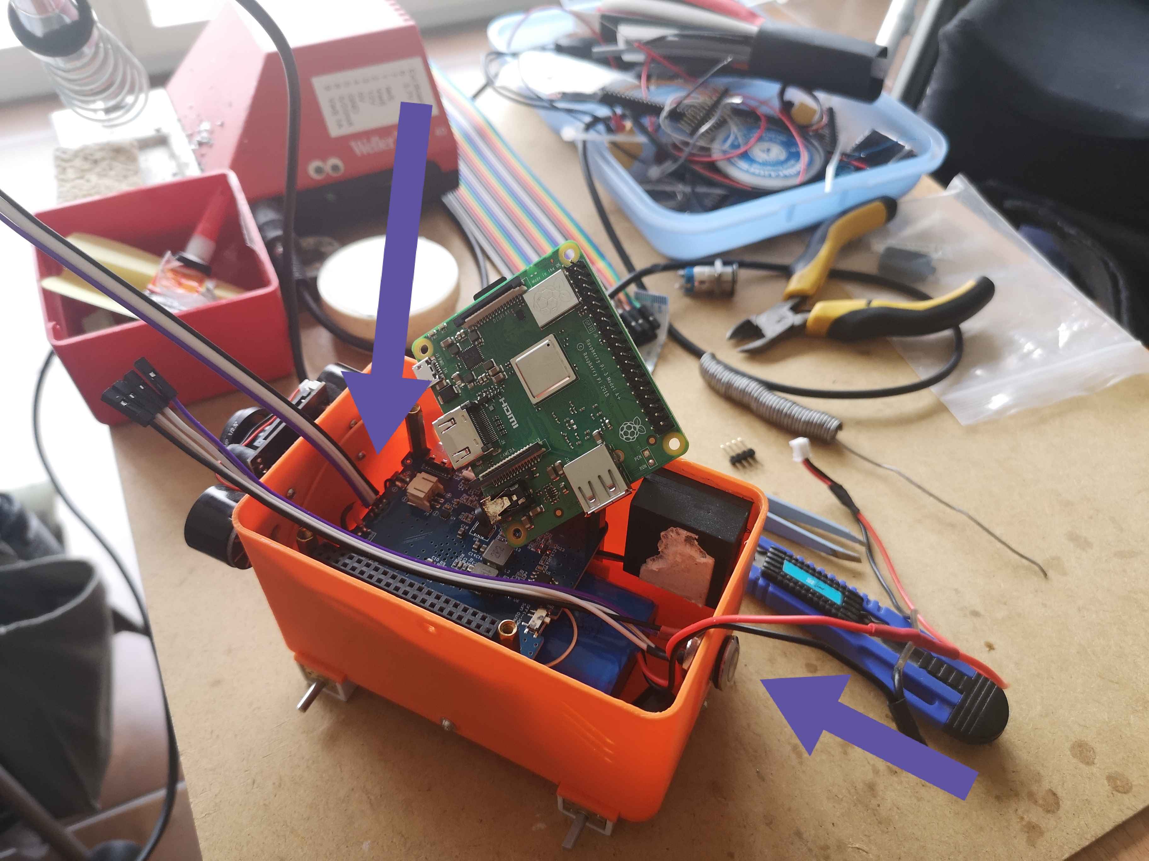

Posté 01 août 2024 - 11:41
Which robot is that on?

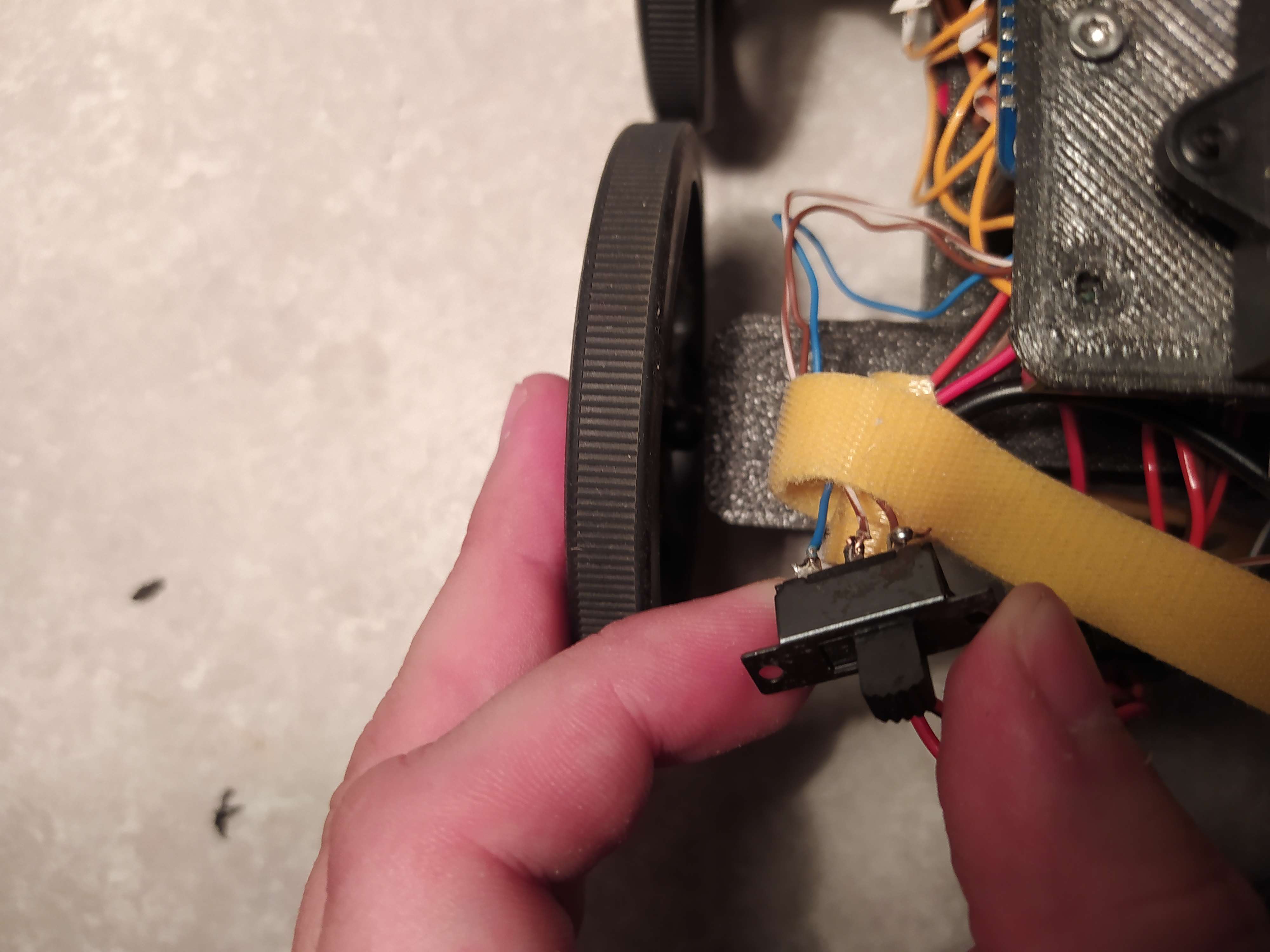

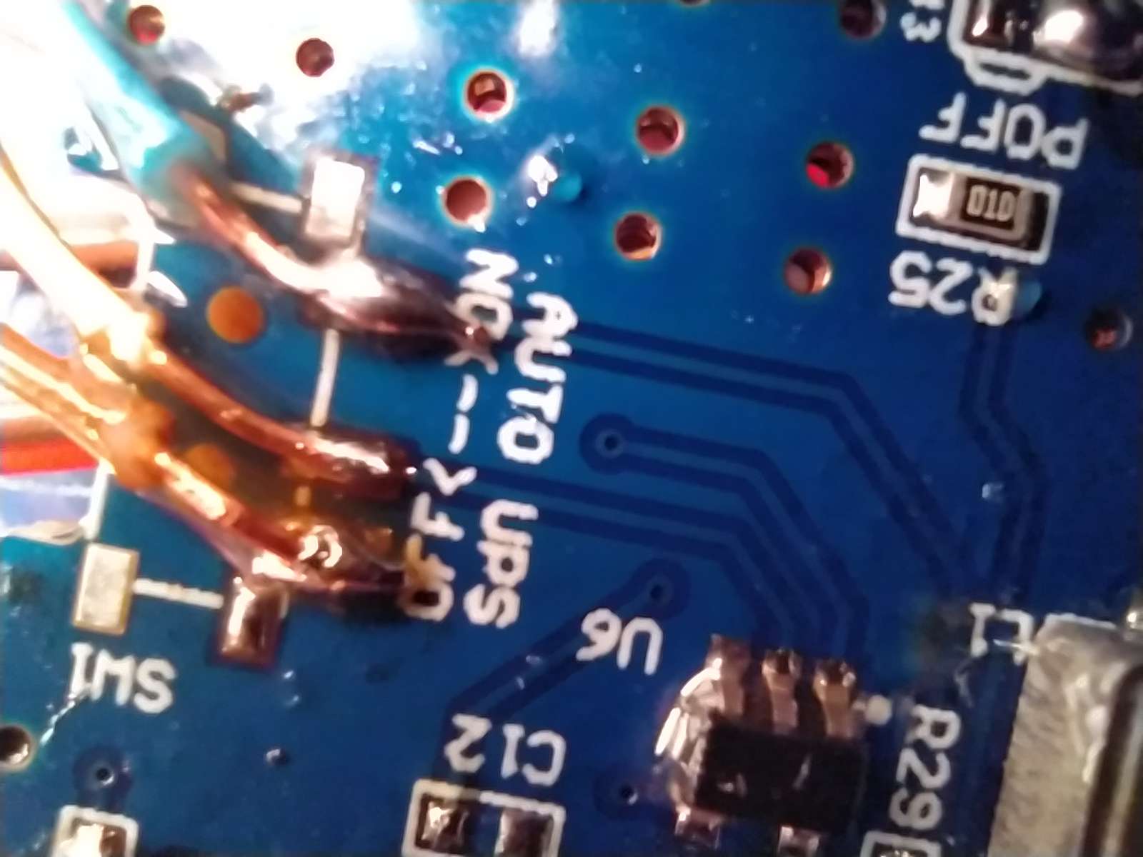

I accidentally broke off the tiny plastic on the ON <---> OFF switch, so I completely unsoldered it, and soldered new wires to an external toggle switch. If I touch any exposed metal on the UPS or the pi, it sometimes crashes. Sometimes it will just crash while charging, and the motors go crazy.

Posté 01 août 2024 - 11:48
I'll take some pictures, then I'll try to resolder it

I completely removed the switch now, and soldered a tiny piece of wire to keep the UPS on permanently. Let's see if that fixes the stability issues

It seems stable now. Maybe the toggle switch wire was picking up noise that interfered with the UPS?

Wait - you turn it on and off using the auto-ups switch?
The extension i made is for the ON-OFF push button.

Posté 08 août 2024 - 14:56
Yes, that's what I used :P

There's something up with that UPS.

Normal behavior is to use the on-off button.
The auto-ups is whether it's supposed to turn on when plugged in and empty battery ( => always on).

What happens if you try 3s the push button with auto-ups off?

I'm not going to resolder it to auto-ups off just to test it, but if I remember correctly, it turns on and works, but if it crashes for whatever reason, it just turns off and I have to hold that button again to turn it on
