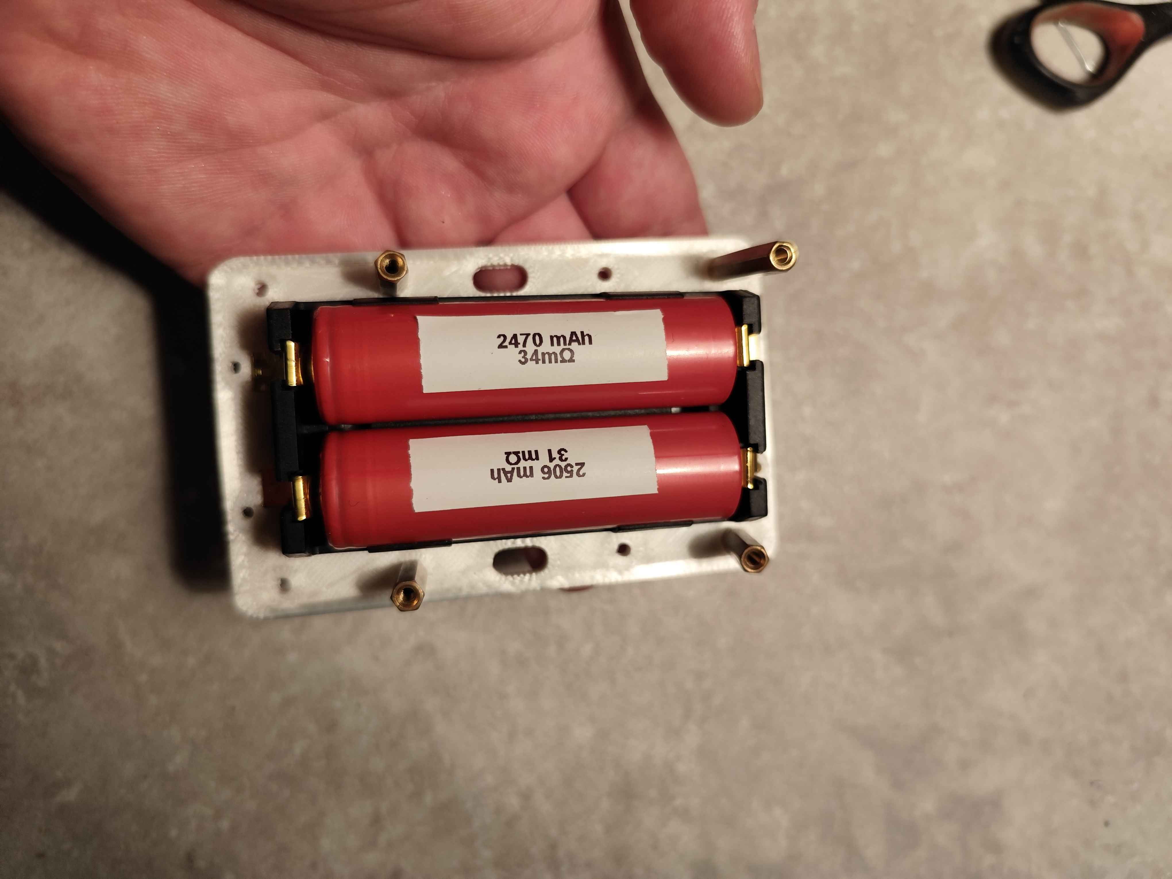

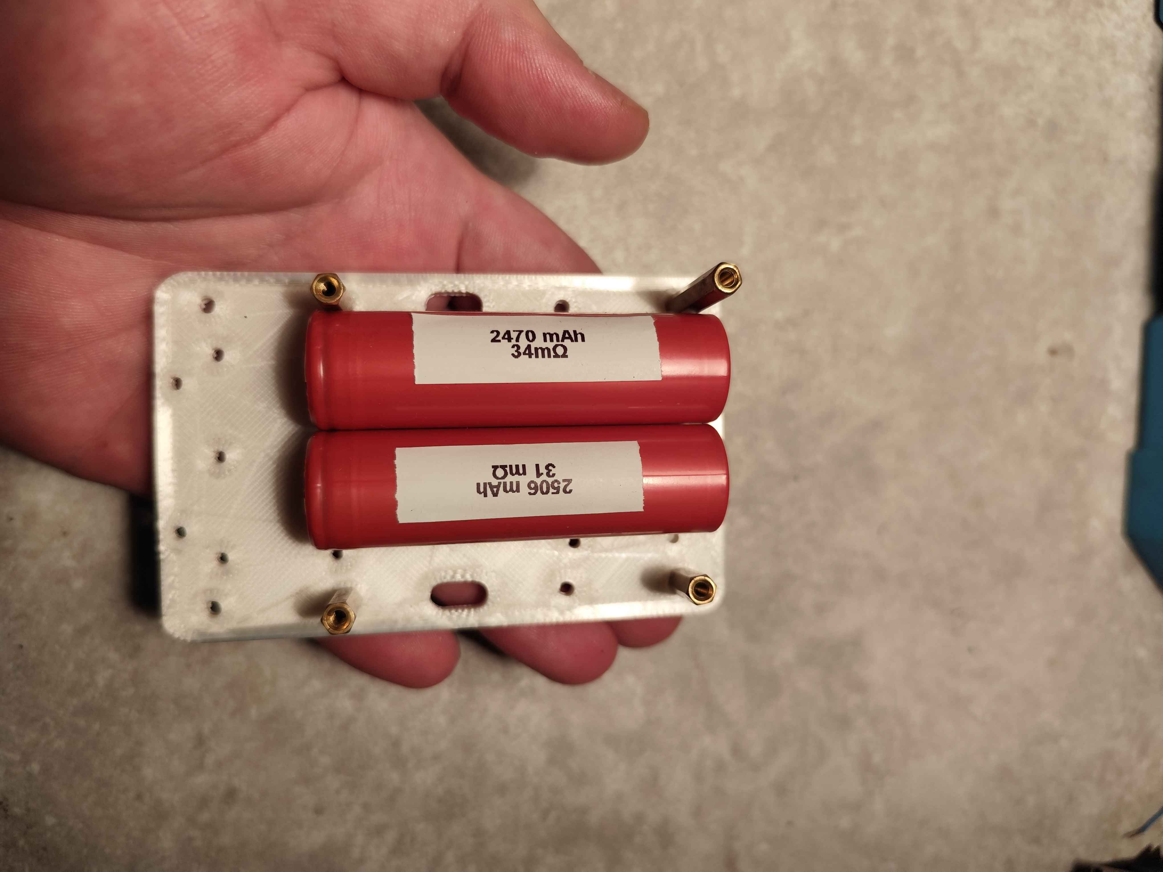

#1569 garfield2142
garfield2142
  • 379 messages
Posté 24 décembre 2024 - 13:01
I have 10 pieces of 18650 holders in my basement exactly for this purpose. If my batteries become weak too, I'll replace them with a holder too. However, It takes significantly more space and weight. The minus big wheel type already suffers from too much stress on the n20 motors.
#1570 garfield2142
garfield2142
  • 379 messages
Posté 24 décembre 2024 - 13:07
Size difference between 2 batteries raw, and 2 18650 holders
