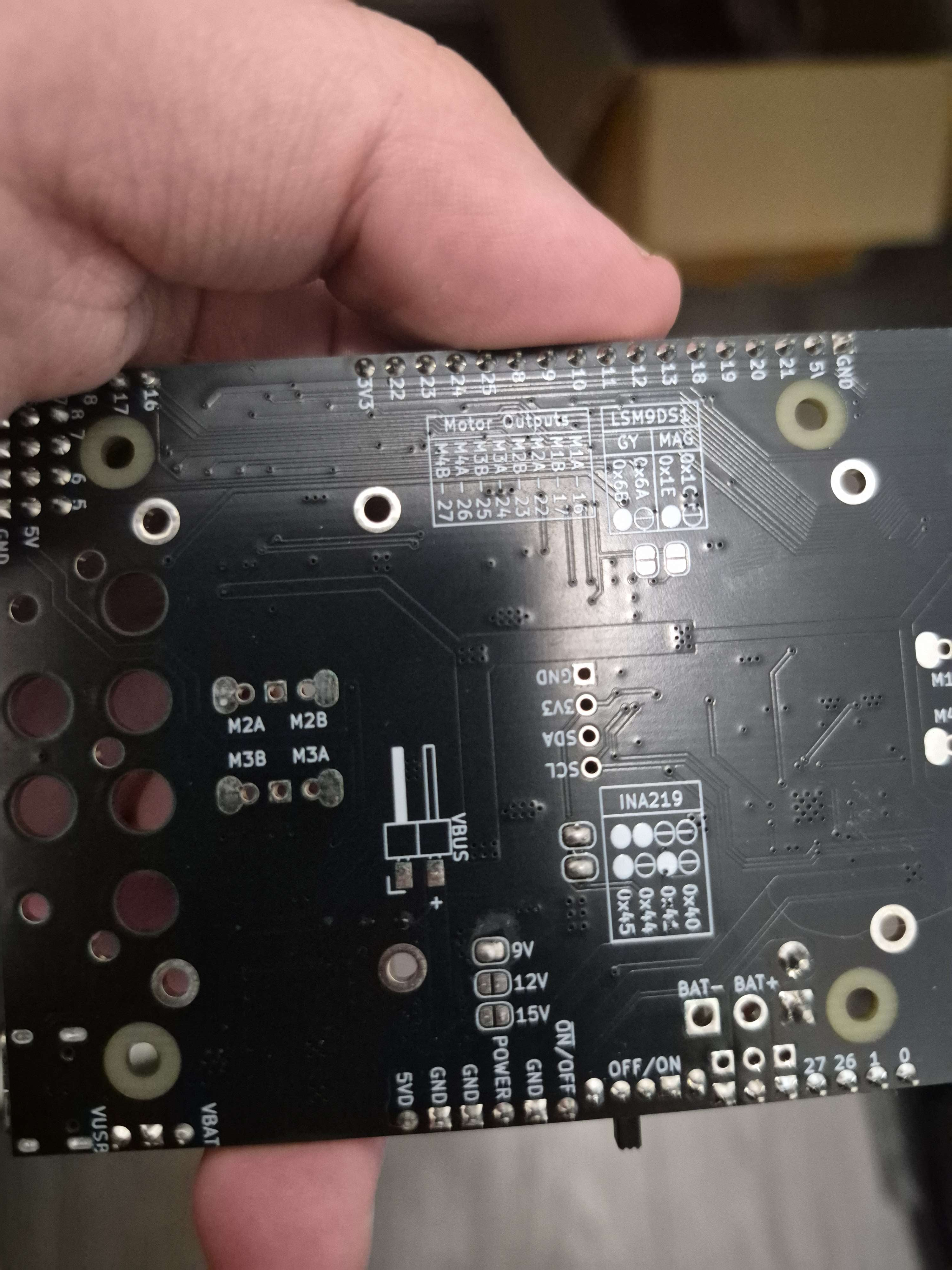

@Mike118 The servos and speaker on CakeOnIce don't fully work anymore. They are all switched together on the VigiUPSv3.
It's as if the transistor doesn't fully conduct, perhaps it doesn't get enough signal on the Base or it's broken. Hmm
#1783 Mike118
  • 12 871 messages
Posté 01 septembre 2026 - 13:16
This is the whole step down that is enabled or not

Do you have an idea what it could be?
The servo power is currently configured to turn on when the robot is awake, and turn off when it sleeps. Without any UI button
#1785 Mike118
  • 12 871 messages
Posté 01 septembre 2026 - 19:09
It seems that the problem was in the config :)

1) These plastic servos are so loud i can barely understand what they're saying. Luckily we will not use this plastic servo.
2) somehow this minus 2S (Esmeralda) started whining loudly when on the charger. The voltage fluctuates between 8V and 8.4V, which could be a hint that something is turning on and off repeatedly. Perhaps Charge module, charger or battery.

2) the noise itself comes from the robot (but not the speaker). I don't have the robot with me, i should check next time.

I have the robot Esmeralda with me now. The noise comes from inside the robot, not the speaker and not the servos.
It stops when i unplug the pi, but starts immediately after plugging the pi back in.
What can i check?
1) change charge terminal voltage
2) ?

What is the voltage set on the upsboard with the small solder joint ? You can try to change it

If i remember correctly, 12V. But the charger is only 9V capable.
