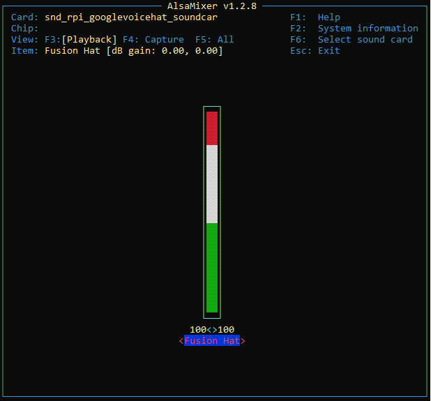

Is it possible to make it louder? Or to use a different speaker

It's at 100% on alsamixer. I'll have to try to crimp a new connector on the 3W speakers that we love and use, and test that as well.

Hm. I'm not sure if alsamixer is still used

The fusionhat uses pulseaudio, it might bypass alsa

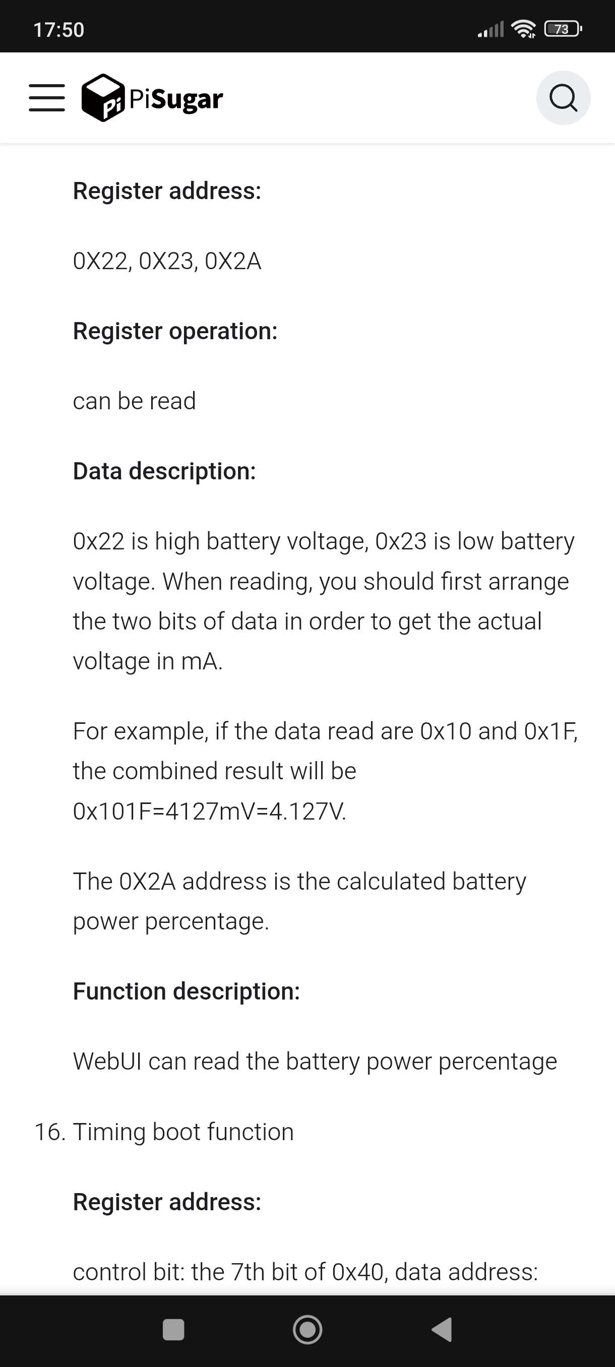

I was looking at the Pisugar UPSes datasheet, and this part is kinda goofy ... "voltage in mA" xd
