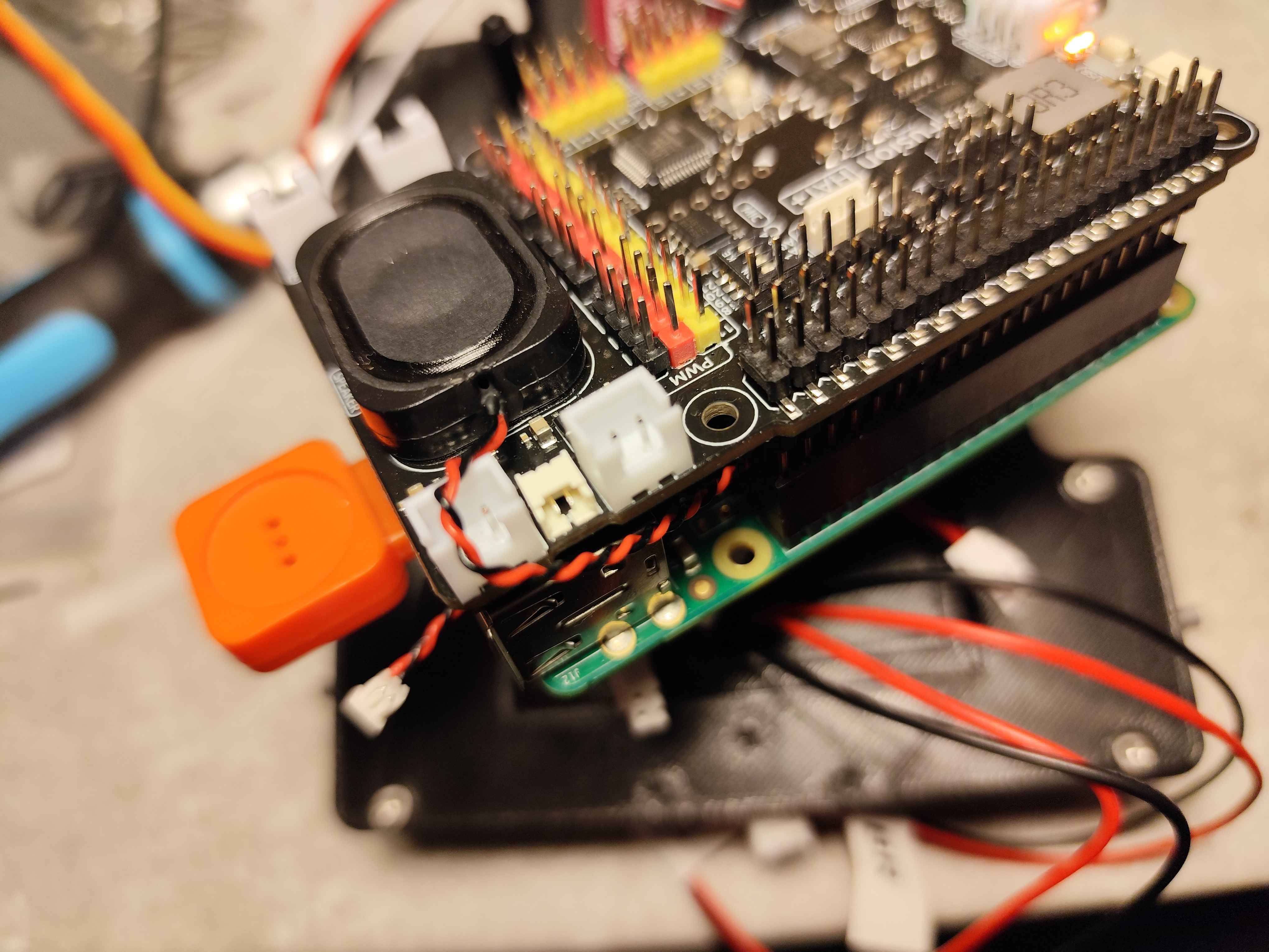

What if you unplug the onboard speaker and connect the good neodymium one?

It uses such a tiny connector, I dont have a plug for it

The sound is significantly better with this speaker, but still not as loud as a PAM8302A

Hm ok

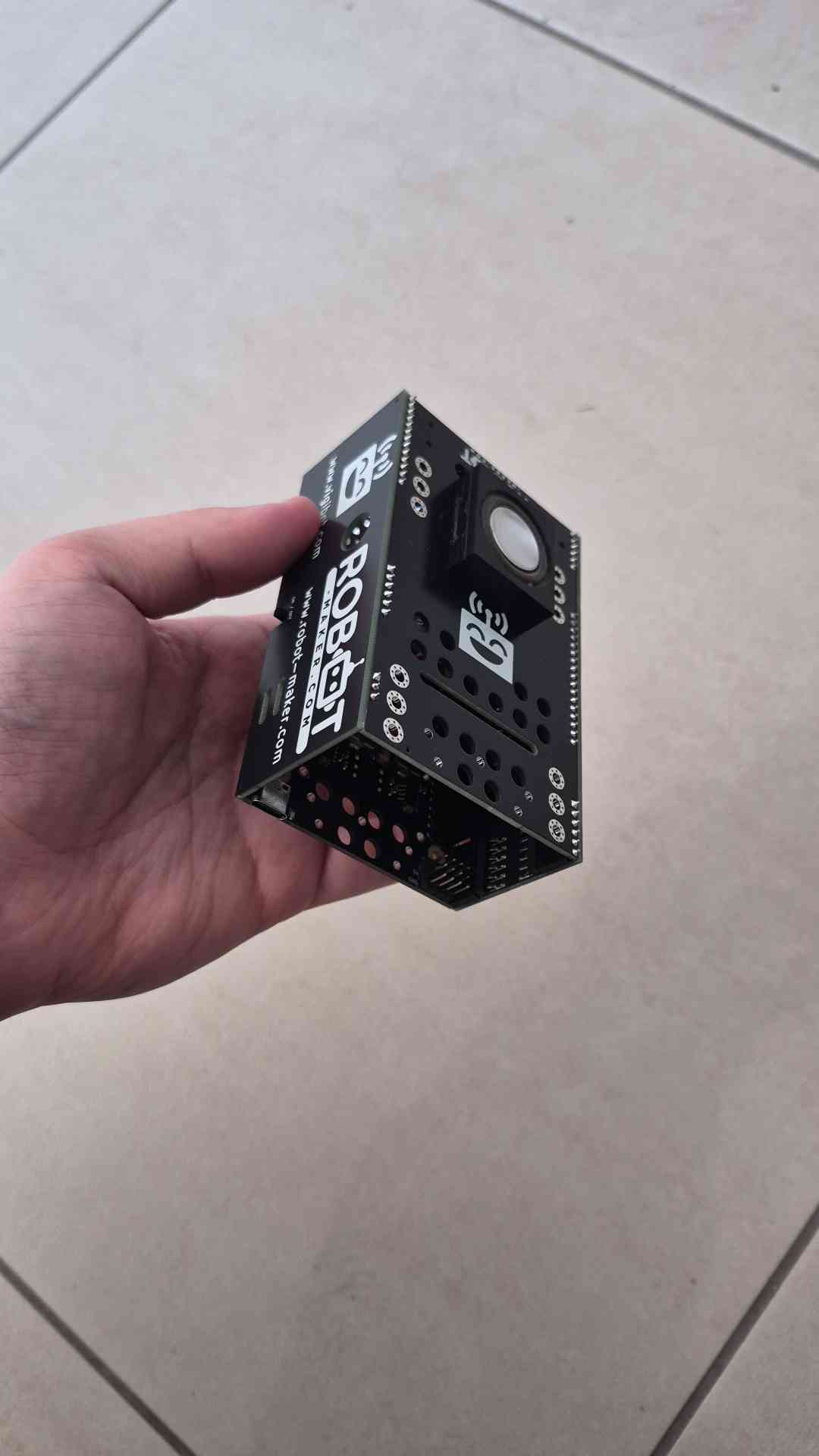

I am now testing the PiSugar 3 Plus UPS. So far, it's quite nice. It has both USB-C and microUSB inputs. It's very slim and hugs the raspberry pi from the back, not obstructing any GPIO pins. It connects with pogo pins to the two 5v pins, GND, SCL and SDA. I connected 2x18650 samsung cells in parallel to it. It has some RTC shutdown-wakeup functions that I am yet to test.

#1769 Mike118
  • 12 871 messages
Posté 20 avril 2026 - 17:26
interesting way to mount it :)

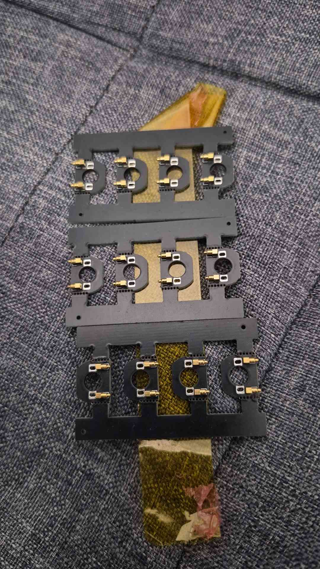

I'm a bit suspicious about the reliability of the pogo pins, how they'll handle vibrations, but I'll write if I find any instabilities.

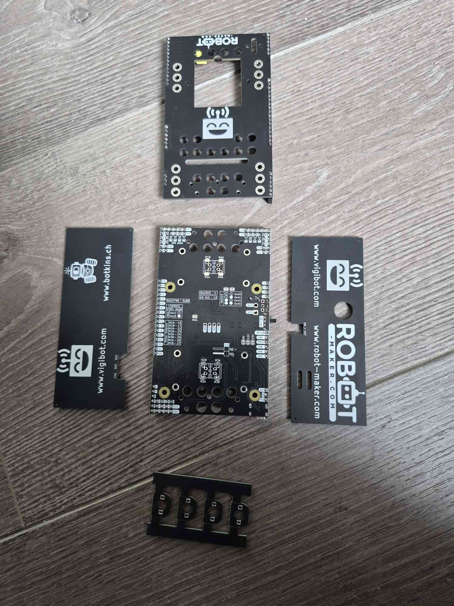

I shared some pictures showing what I am preparing :)

I believe pogo pins are a great solution :) this is what I choose for the motors
