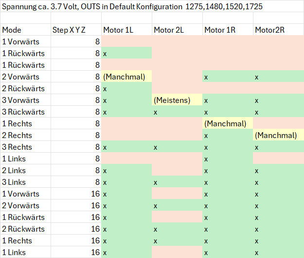

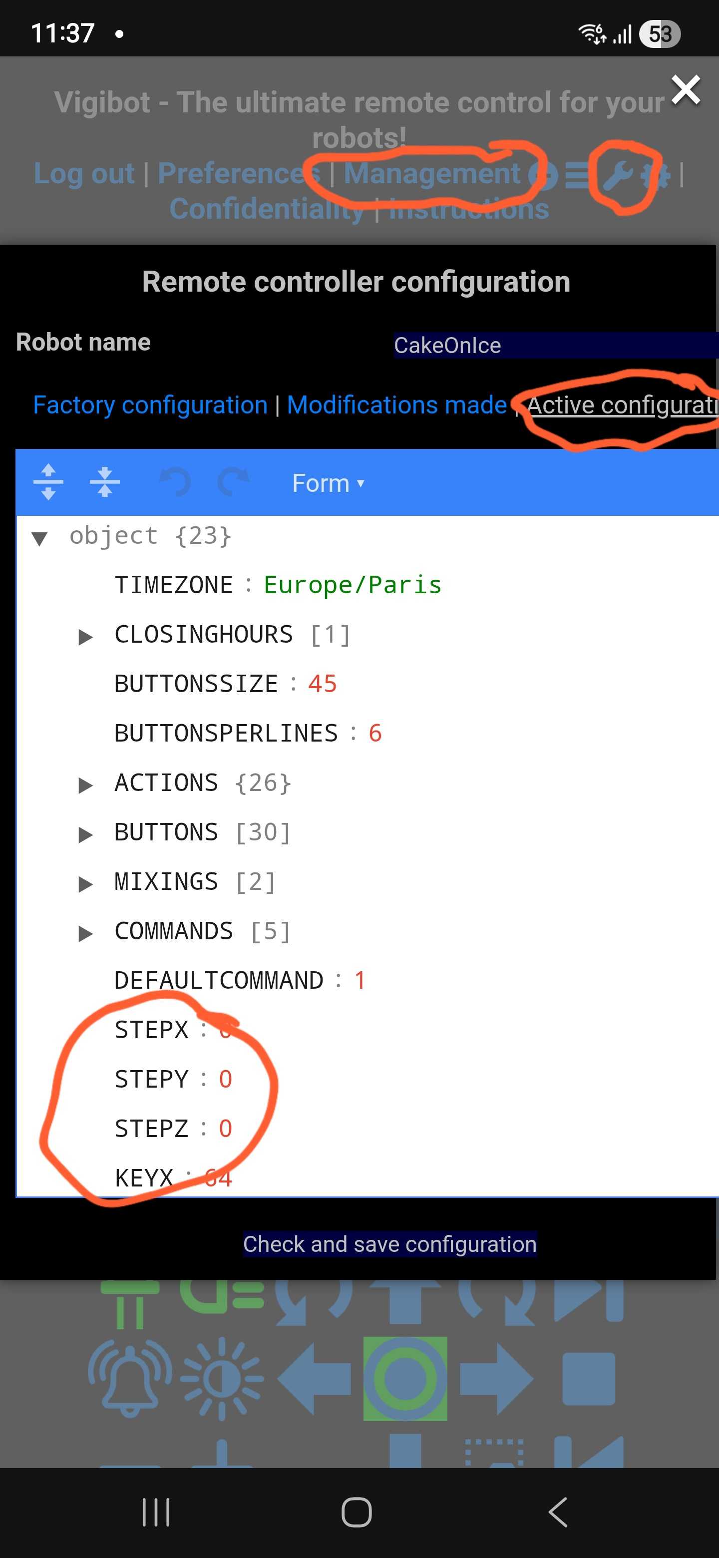

I couldn't find a file with a STEPY value inside. However I could make some adjustments in the hardware configuration with the "OUTS" values for "Left wheels" and "Right wheels".
But it is still a bit frustrating with those values for several reasons: frist you have to sacrifice the lowest possible speed and second there is even a dependency of the battery voltage. I had a running configuration. But after the voltage dropped a bit the problem reappeared, one of the motors wasn't starting with the lowest speed.
It is clearly a mechanical problem of at least one of the motors. Maybe I try to apply a bit of oil in the gear box?
You wrote that the roboter is rarely controlled using the pulse key. In my opinion it doesn't which input device is used to control the speed (at least if the slowest possible speed is the same for all input methods).

Posté 24 février 2026 - 11:39
STEPY and STEPZ are here
#1726 firened
firened
  • 2 124 messages
Posté 24 février 2026 - 11:46
Adjusting STEPn might be the best option in my opinion.
Scenarios to consider:
- robot may be on an in- or decline. Driving forward may need a very small amount to move.
- when driving forward with the joystick, it must be possible to apply tiny left and right commands or driving will become frustrating. -> Preferably no INS or OUTS adjustments.
- i use the pulse key as autopilot. I click the pulse key multiple times forward and then add 1-2 clicks left or right depending on terrain (floow may not be level). If you increase the minimum PWM, using it like that would not be possible anymore, since it'll turn too fast.
#1727 ralph_62550
ralph_62550
  • 11 messages
Posté 24 février 2026 - 14:38
That's how it looks like. It makes a difference how long you wait between different tries. It looks like when the motors just have turned before the chances are bigger that they turn with lower steps. Motor 2L is the one with the biggest starting difficulties.

Posté 25 février 2026 - 08:32
On low battery the last motor starts turning on click 8

Thanks for testing. It is good to know the effect of low voltage. What is your defintion of "low battery"?
#1736 firened
firened
  • 2 124 messages
Posté 27 février 2026 - 10:00
The video was taken at around 3,1 - 3,2V Vbat.
Though i consider a battery to be low below 3,5V usually.
