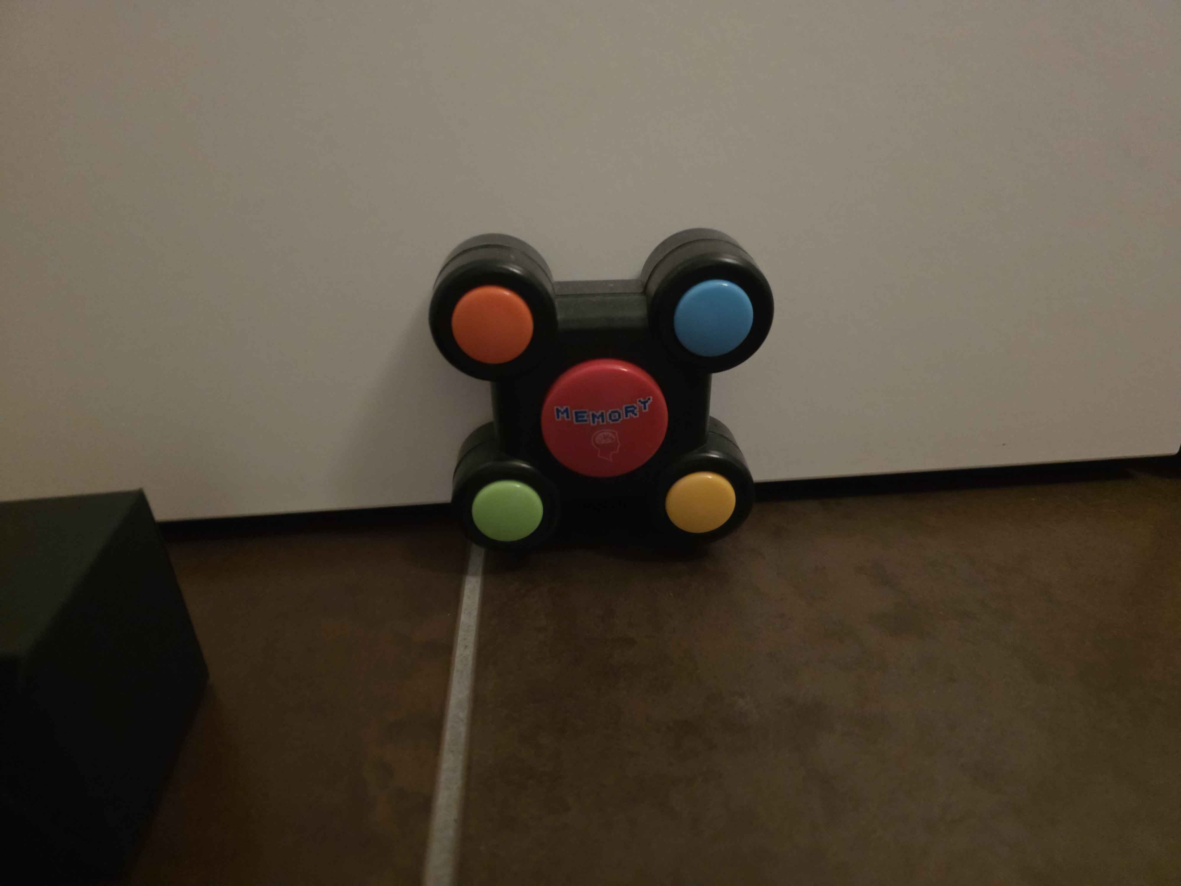

A) Come and try to slowly drive a straight line right next to the 2m ruler. this is my attempt with the robots UPS and ibiouda:

B) Come and press the yellow and green buttons in succession. Tell me how often you accidentally overshoot a rotation.

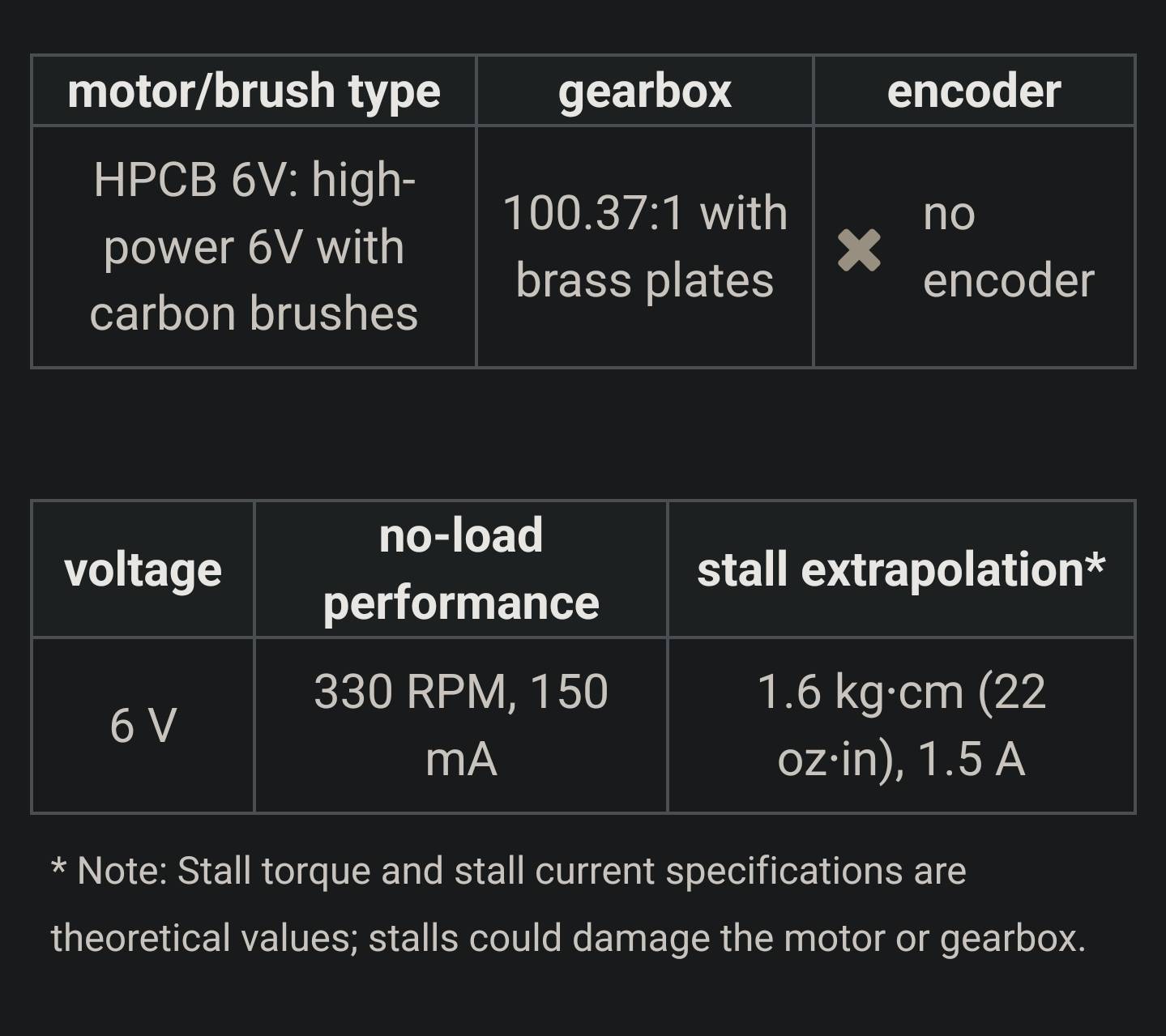

Given that UPS's rpm is so close to double of ibiouda's, they're almost surely the same model.
And Pololu lists 330 rpm @ 6V for that model, that checks out.

The modele we usually use is the HP version not hpcb. But yes I should have send you the 100:1 gear ratio.

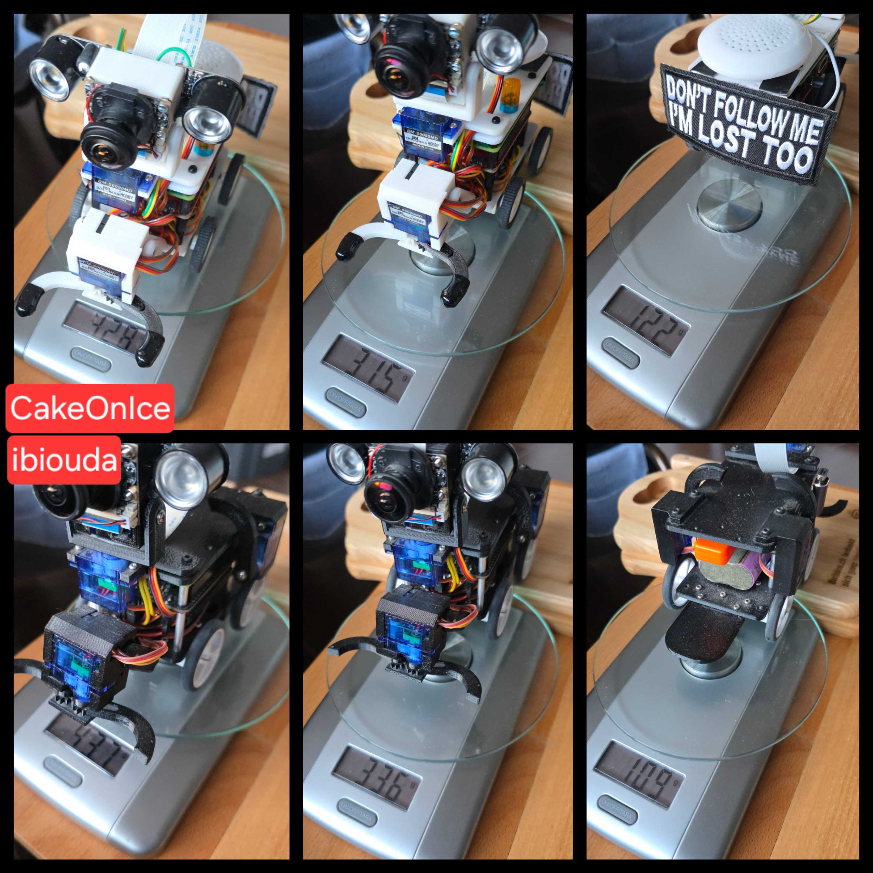

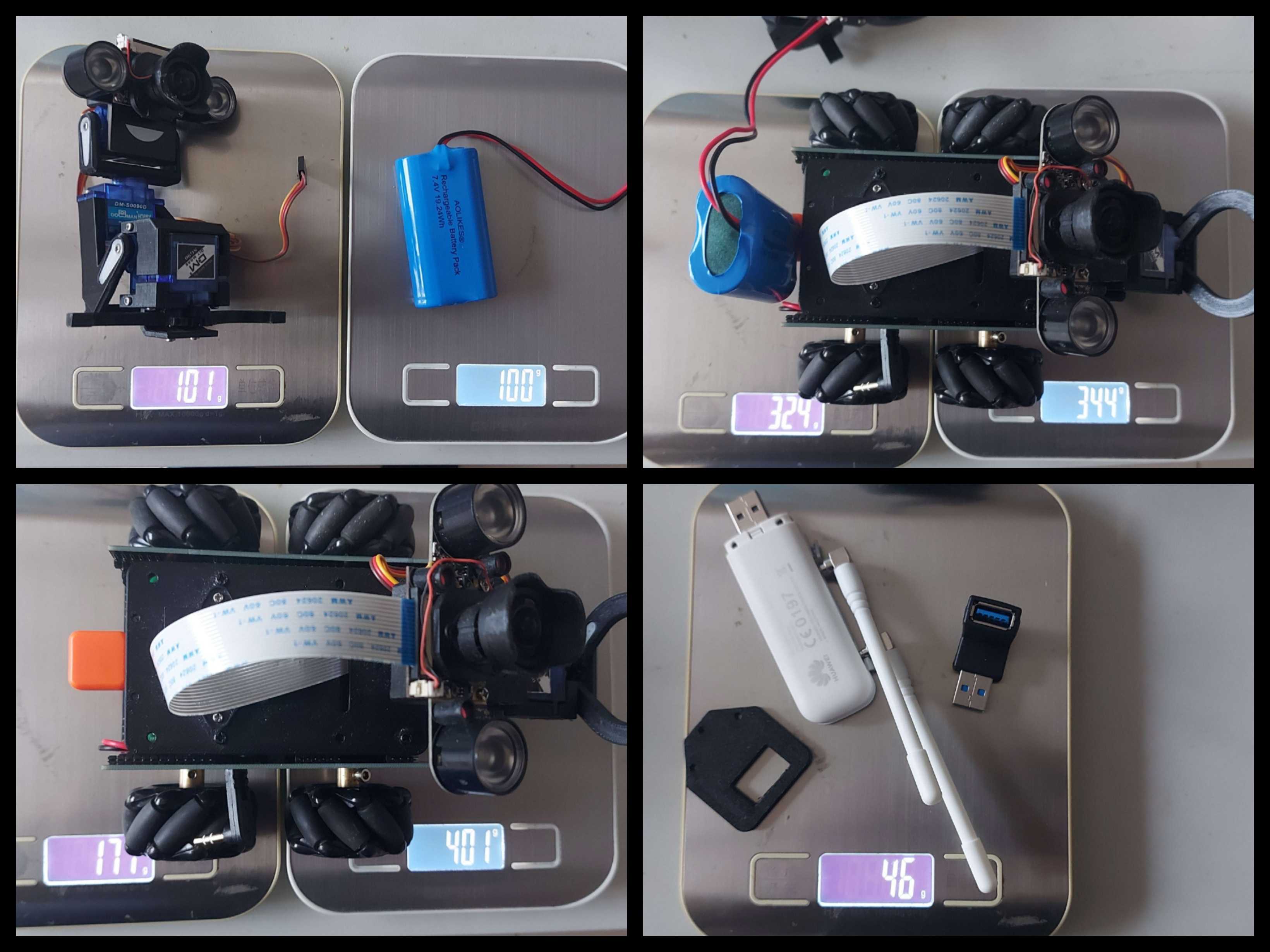

Center of Gravity data.
@Mike118 thank you for measuring the new board.
