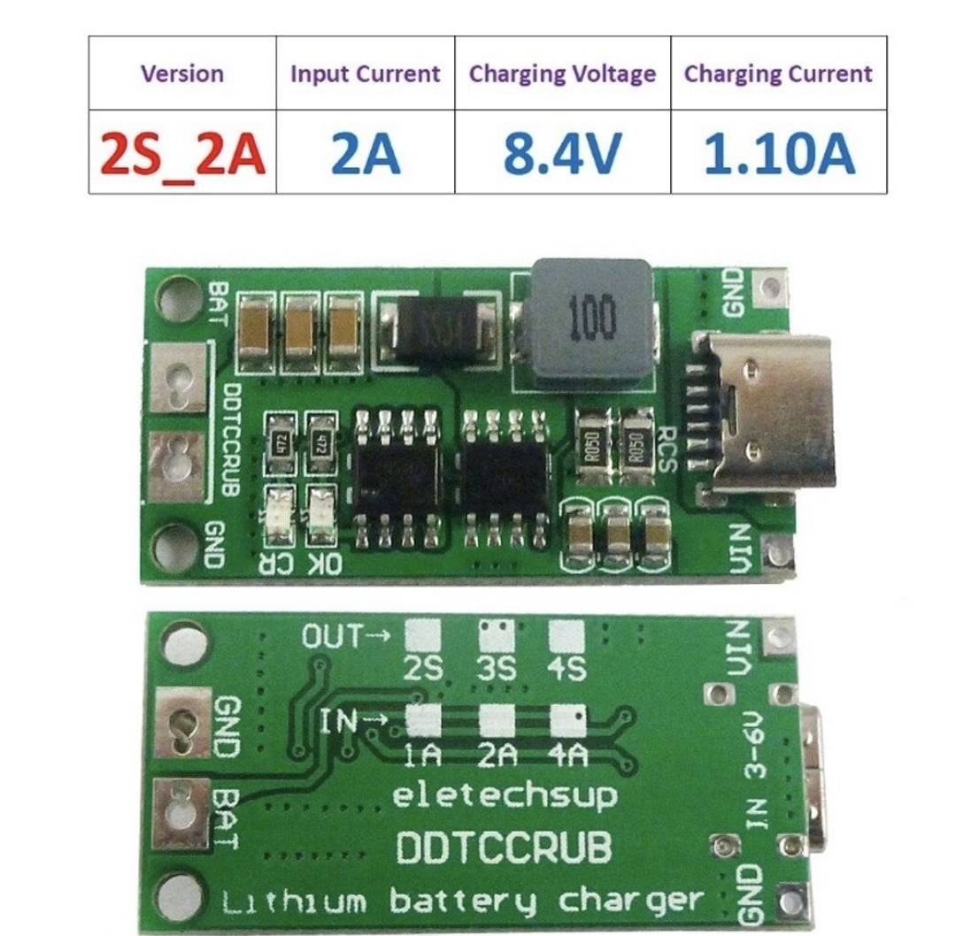

I had something similar with my charger for 18650-type batteries. There was a chip that got really hot-I don't know exactly how hot-but it was hot enough to burn a finger.
#1657 wowhik1

Here's the board, I guess this is typical for it.

I tested this one and it works but not " great " it only use 5v input and get hot quickly with charging current at around 1A or less.

Posté 04 janvier 2026 - 17:25
So my choice wasn't ideal when I bought it.
But in my opinion, it handled charging the batteries perfectly well.

That's a perfectly fine charger if you don't plan to keep it on 24/7.
