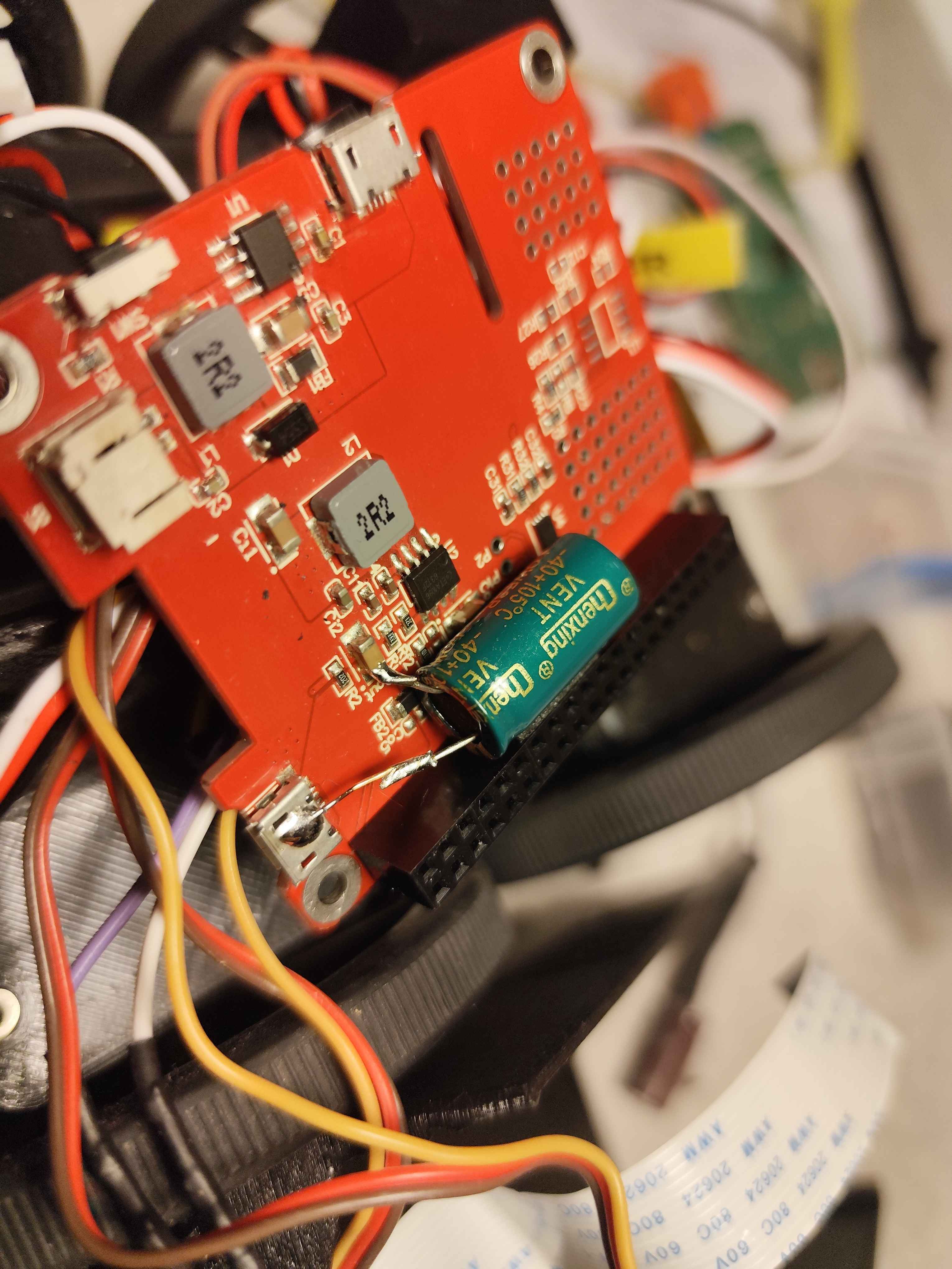

@Garfield2142 now about where the capacitor goes..
#1629 garfield2142
garfield2142
  • 379 messages
Posté 28 décembre 2025 - 17:55
Oh, so that's why those components are missing on mine!
#1630 garfield2142
garfield2142
  • 379 messages
Posté 28 décembre 2025 - 19:14
10volts, ~3300uF capacitor. Tested it for about 15 minutes, and I didn't see any low voltage warnings on the framebuffer

Posté 31 décembre 2025 - 11:58
The robot won't turn on while it's charging. The blue leds turn off for a second, but nothing happens. I have to disconnect the cable to be able to turn it on. Tried with 2 different chargers, both microusb and magnetic connectors.
#1633 firened
firened
  • 2 124 messages
Posté 31 décembre 2025 - 13:09
~~Did you remove the POFF solder bridge? would be my first guess~~
#1634 firened
firened
  • 2 124 messages
Geekworm UPS3?
#1635 firened
firened
  • 2 124 messages
Posté 31 décembre 2025 - 13:10
Ah no, red UPS. Hm
#1636 firened
firened
  • 2 124 messages
Posté 31 décembre 2025 - 13:11
the button works a bit different on this ups, maybe that.
#1637 firened
firened
  • 2 124 messages
Posté 31 décembre 2025 - 13:14
Hm no not really.
I think it turns on automatically but puts 5V on the OTG micro usb out. Long press switches between OTG out and 5V pi pin header, so should be ok.
What does short press do? In both modes (pi on & off)
#1638 firened
firened
  • 2 124 messages
Posté 01 janvier 2026 - 08:41
@Garfield2142 Could it be inrush current triggering an over current protection?
#1639 garfield2142
garfield2142
  • 379 messages
Posté 01 janvier 2026 - 08:43
I don't know, but I'll temporarily disconnect the capacitor that I soldered in to test if it does that without it too.
#1640 garfield2142
garfield2142
  • 379 messages
Posté 01 janvier 2026 - 09:48
It turns on perfectly fine while charging if I disconnect the capacitor. Maybe it's too high capacity?
