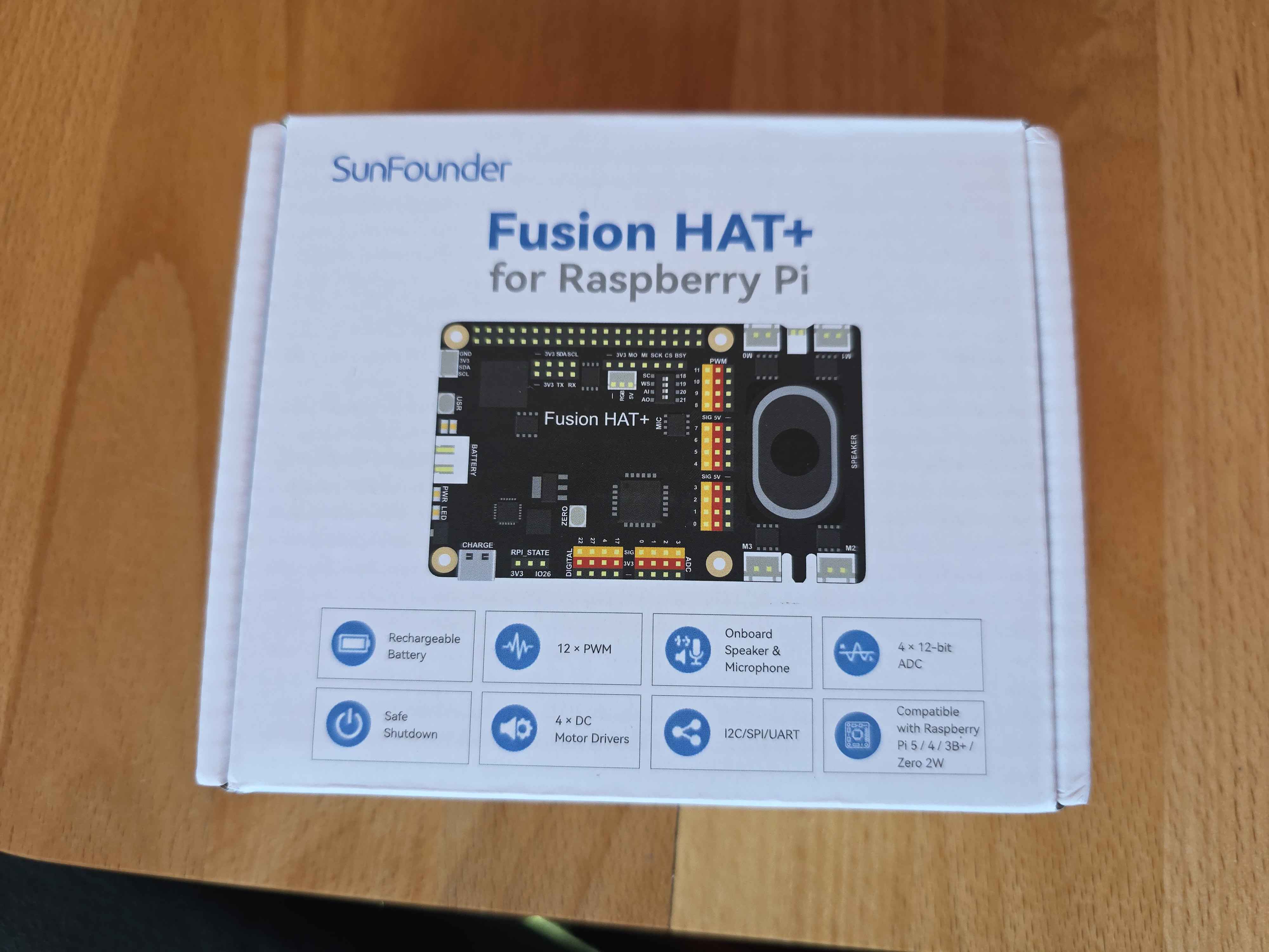

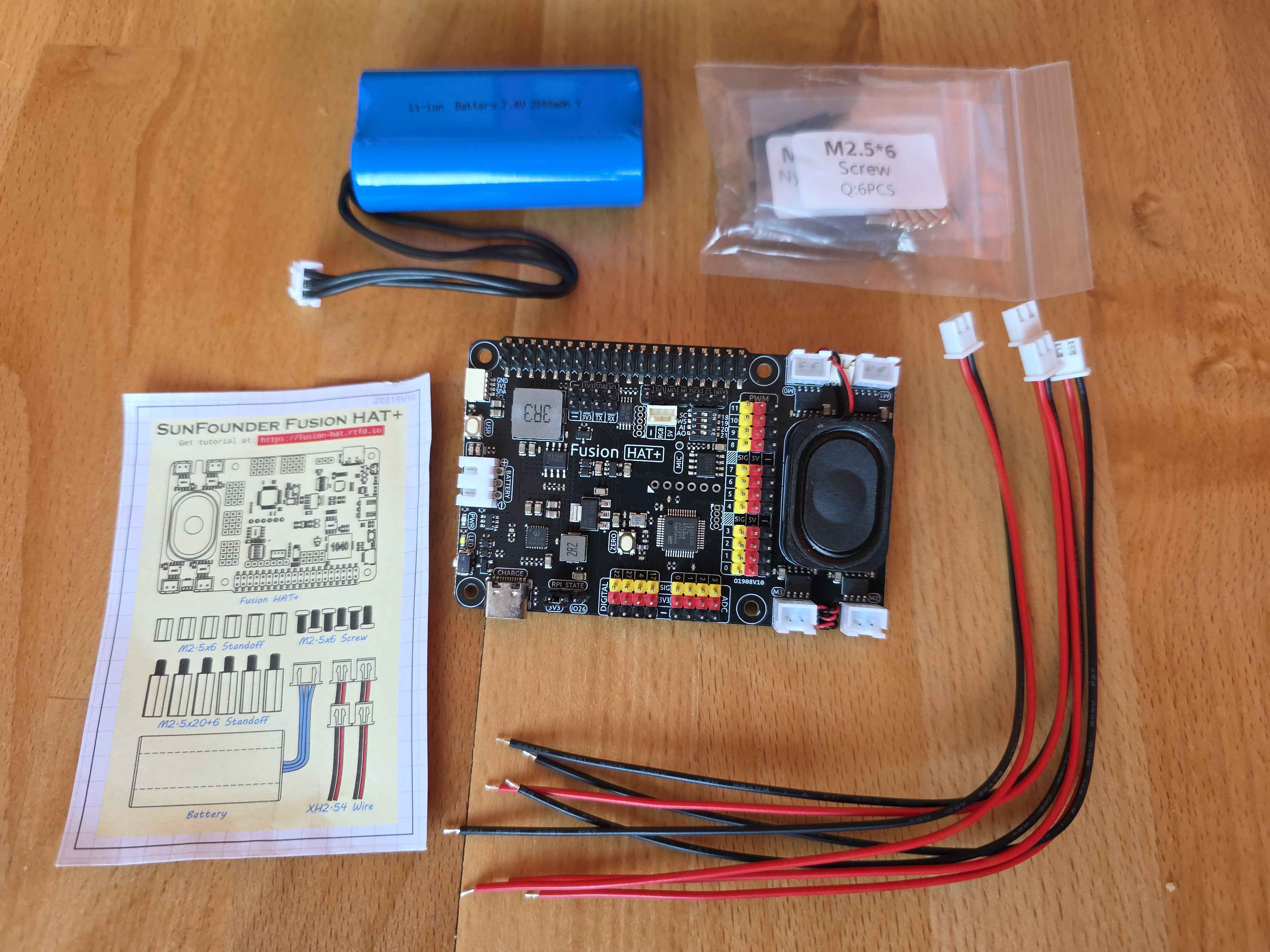

I got the sunfounder fusion hat+ but forgot which tests i was supposed to do @Mike118

OMG, this board basically has everything. How loud is the speaker? Is the microphone as good as the orange one? It's sold out on sunfounder's website unfortunately, but I'll try and order one for myself too.

From time to time here available
https://a.aliexpress.com/_EJtxr96

Audio is I2S, it's not clear yet how that'll work

The goal was to test it as a ups for a vigibot robot. Test the mic , the speaker the voltage readings etc... and check what IC is used

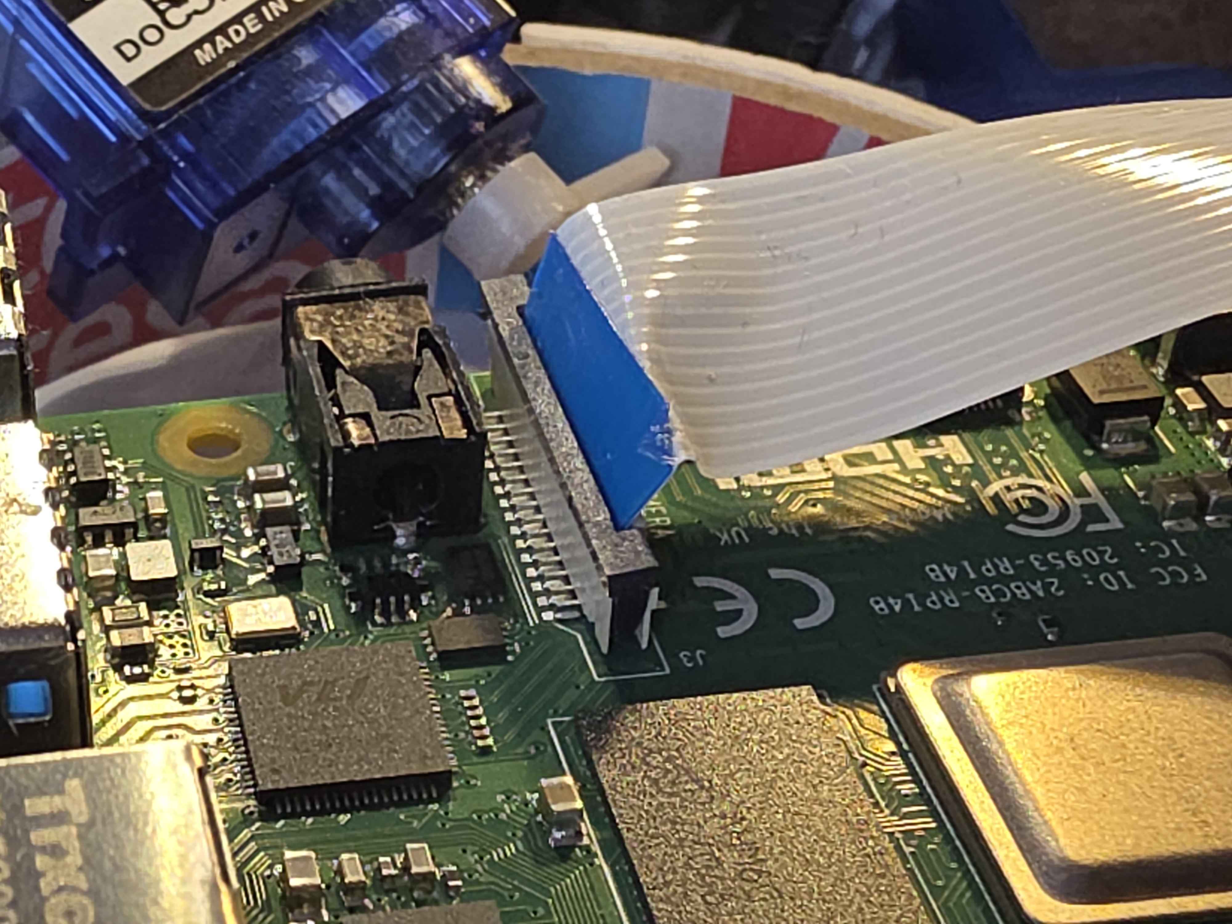

Battery and flex cable are tight with the VigiUPSv3. Does it have an official name yet?

FusionHat:
First observation:
Looks like the PWM outputs are controlled by the MCU. There's no PCA IC.
https://docs.sunfoun...ml#on-board-mcu

Hmmm... So the PWMs are controlled through I2C? Does this mean the clientrobotpi.js will need to be completely rewritten?
#1714 Mike118
  • 12 871 messages
Posté 19 février 2026 - 13:51
Not completely but yes it needs an update to work with it.
