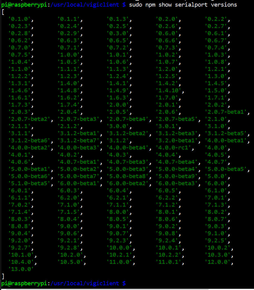

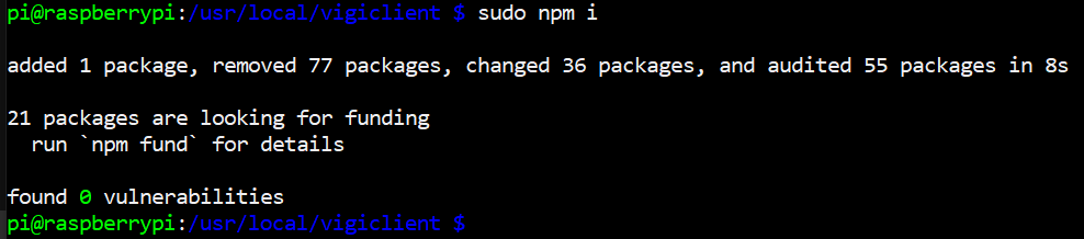

Try these:
sudo npm i
sudo npm outdated
sudo npm show serialport versions
#10579 garfield2142
garfield2142
  • 379 messages
Posté 09 juin 2025 - 10:53
#10580 firened
firened
  • 2 124 messages
Posté 09 juin 2025 - 10:58
Ok makes sense the `i` = install cmd was necessary xD
:white_heavy_check_mark: Serialport
Try again the i2c and pigpio cmds then check outdated if version changed
