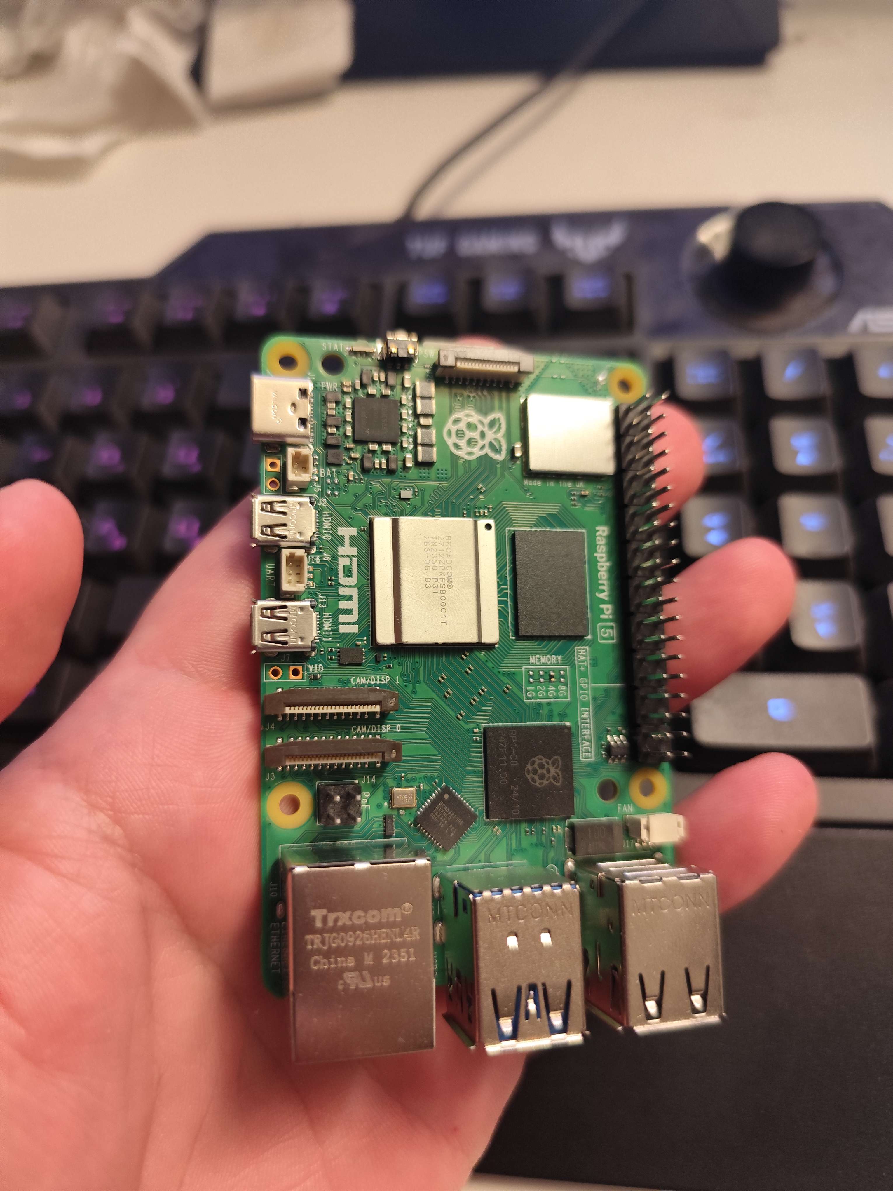

I just realized that the pi5 doesn't even have a headphone jack, which I rely heavily on for my robot projects. I just lost all interest in trying to make this platform work. I'm going back to the pi4 and pi3. If anyone wants to continue, there's the clientrobotpi file above. This one is going back into the box until I decide to make it into a NAS or router.
