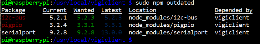

`pi@raspberrypi:/usr/local/vigiclient $ sudo npm install pigpio@3.2.4
up to date, audited 55 packages in 1s
21 packages are looking for funding
run `npm fund` for details
found 0 vulnerabilities
pi@raspberrypi:/usr/local/vigiclient $ sudo npm install i2c-bus@5.2.1
pi@raspberrypi:/usr/local/vigiclient $`

~~Perhaps another `sudo npm i`~~
Ah no, those are the versions we want :yes:

Should we go forward with this? Mike found out that pigpio :pig_face: is not compatible with the pi5

The move forward is to update the client to remove pigpio dependency ...

Good question.
I guess it depends on whether it was just
pigpio version problem like it was on briecam,
or if it's due to pi 5 hardware changes. How can this be determined?
