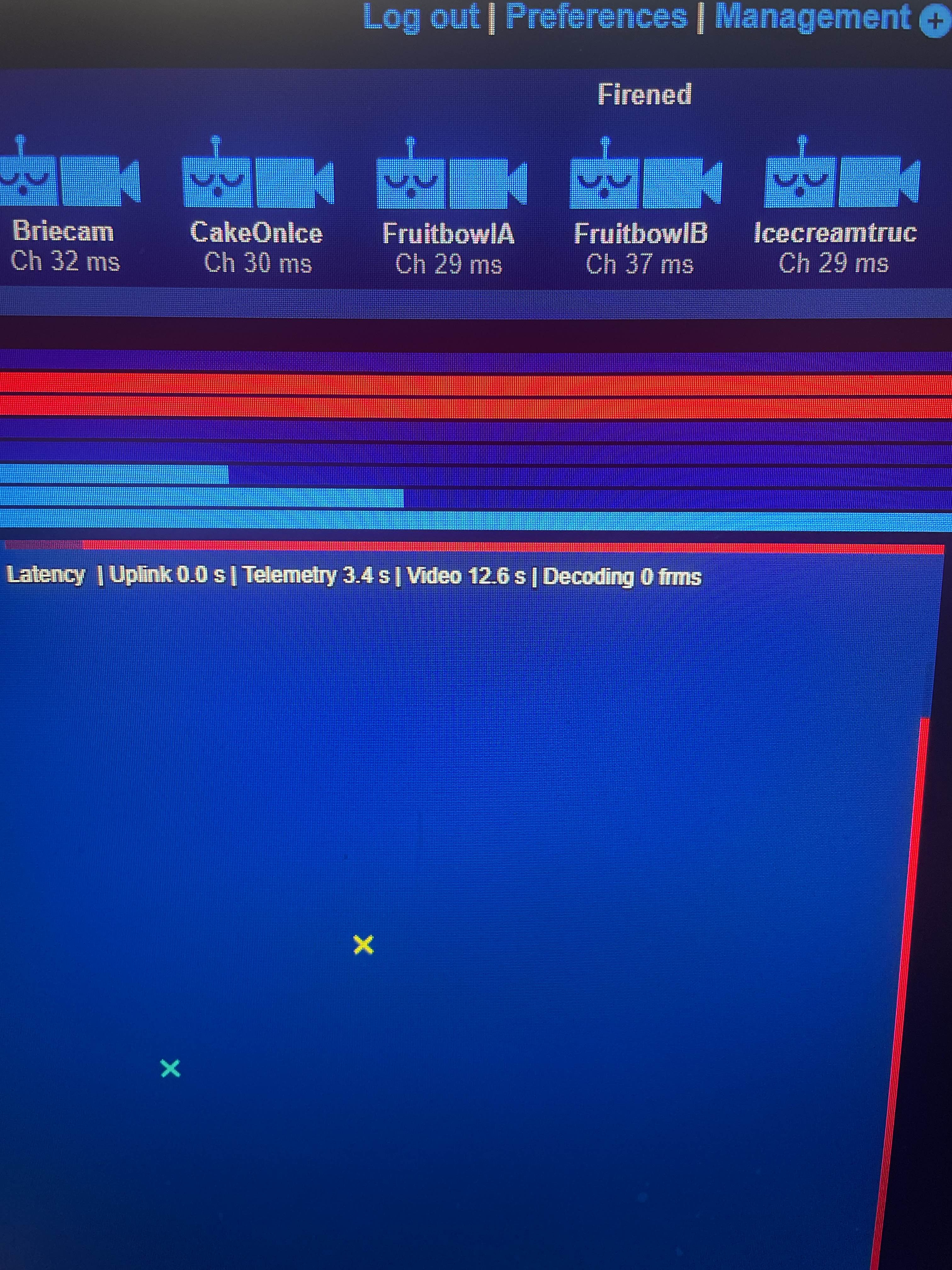

I also double checked to make sure that the ribbon cable is in the correct way, but the numbers on the video just keep going up
#10762 Mike118
  • 12 871 messages
Posté 22 décembre 2025 - 12:33
This look like the camera is not detected...
The vigibot image is a standard raspbian image with the open source vigiclient already installed
you can test the camera manually by connecting on the raspberry pi using ssh.

@QuantumFlip The Chillet
Since you have confirmed that it works on another OS, a hardware failure can be ruled out. The issue appears to be a driver stack mismatch. This image likely expects the Legacy Camera stack. Try running sudo raspi-config -> Interface Options -> Legacy Camera -> Enable, and then reboot the system. This feature is disabled by default.

I noticed this earlier, but by default it's not possible (I tried it on my old Raspberry Pi 3B+). Other settings may be required, because when I moved the mouse wheel to switch the mode, nothing happened. I know very little about the VIGIBOT system and how it is configured. I will look into the source code later.

You can change the camera source to 1 instead of 0

Which version of raspberry pi camera module is this? 1, 2 or 3?
