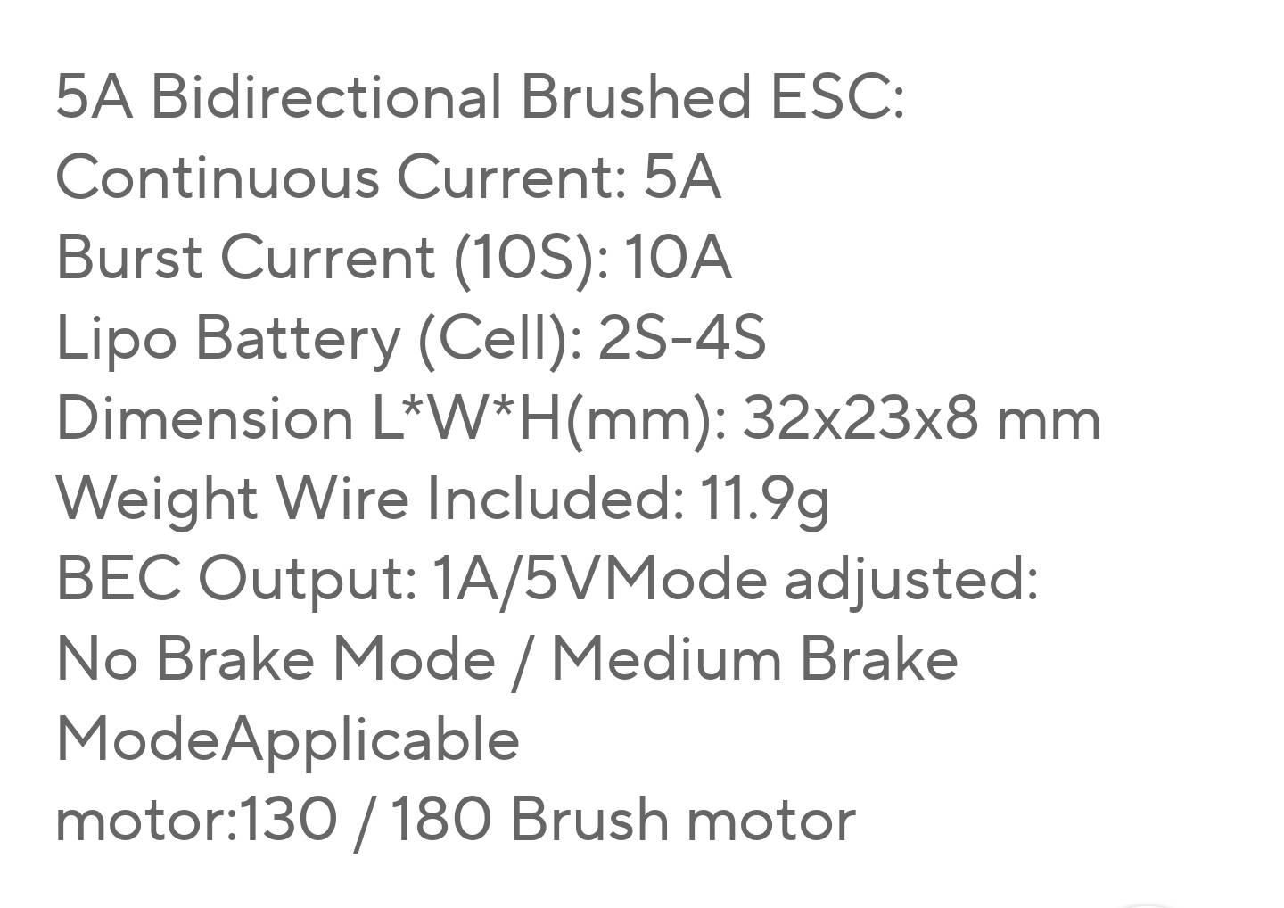

@HyperS the WPL B24 could work. It has a combined receiver+ESC board, so you will need your own ESC. But you can get a smaller cheaper ESC like this 5A version
https://aliexpress.r...8085017227.html
Yeah 18650 from AliExpress is risky.
I buy them from a local swiss store.
Up to you :yes:
You'll be able to use it for other larger motors as well, so can make sense.
Both should work fine. The WPL B24 has a "180" type motor, which is listed as compatible on the 5A ESC specifications
