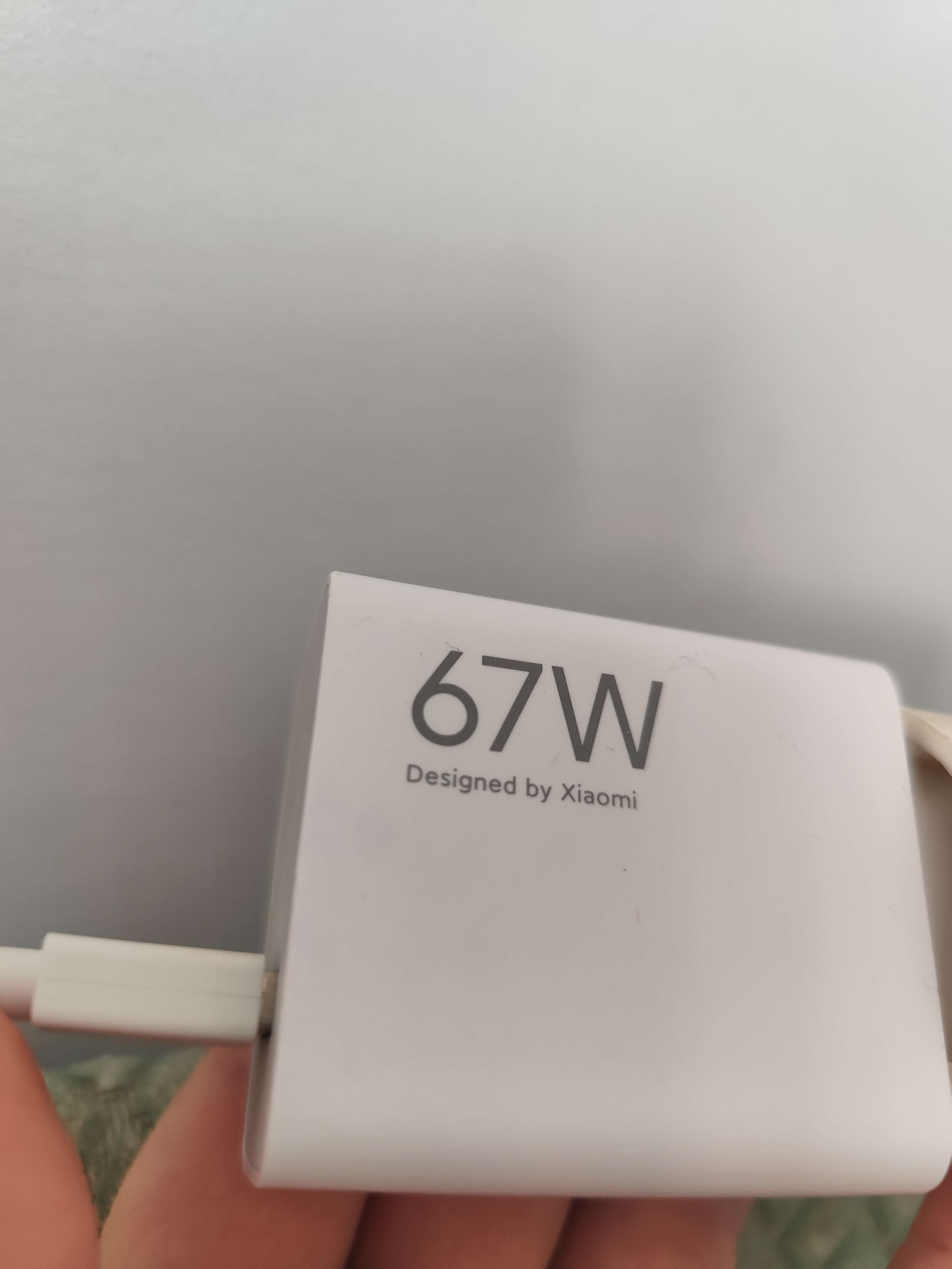

Is it this one? If it's this one, I've had some problems with it. It only likes to charge xiaomi devices correctly. Everything else will either charge really slow, or constantly start and stop charging.

It's common. Mine show warnings too sometimes.

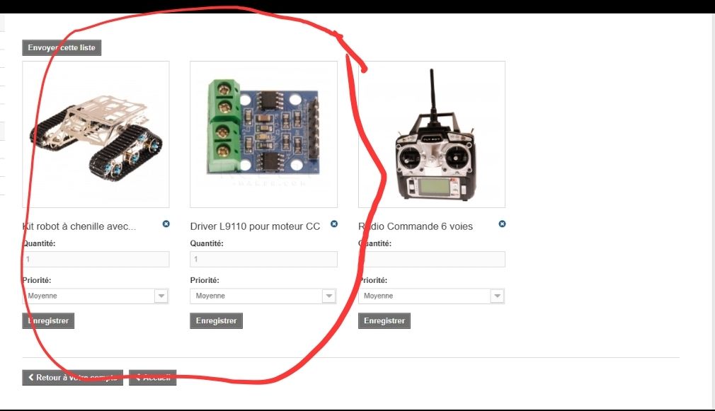

@Mike118 un robot on chenille c'est bien meut ? Que sur roue
#10253 Mike118
  • 12 515 messages
Posté 09 novembre 2025 - 10:12
Ça dépend pour quoi. Il y a des avantages et des inconvénients. Un robot sur roue c'est déjà très bien.
#10254 arkansar
arkansar
  • 28 messages
Posté 09 novembre 2025 - 10:13
Ha je vois
Il faut avoir le driver ?
#10255 Mike118
  • 12 515 messages
Posté 09 novembre 2025 - 11:34
You can use another driver if you already have one.

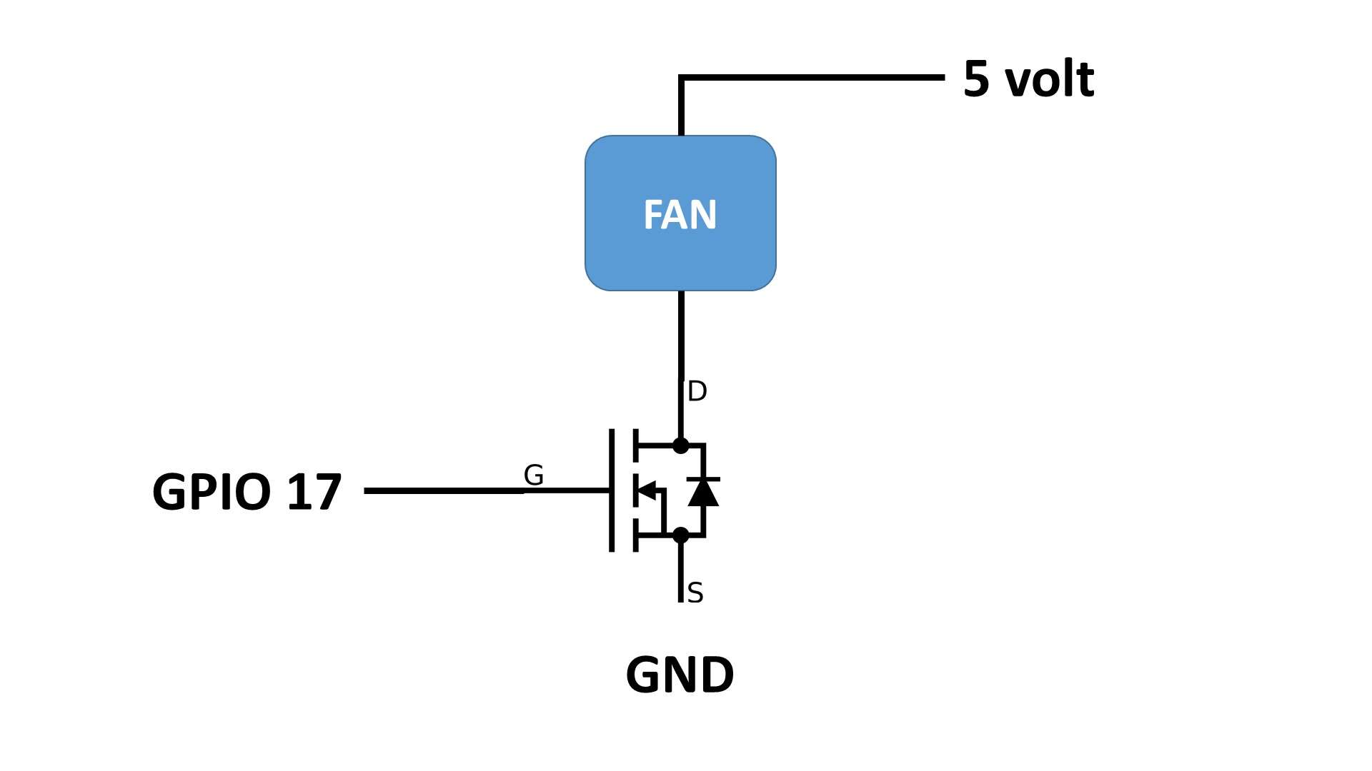

Options are:
1) no soldering:
https://aliexpress.c...0298159107.html
https://aliexpress.c...0290163842.html
2) cheapest and very versatile: FET, For 3.3V good are N-CH FQP30N06L + P-CH NDP6020P + 10 kOhm resistors.
3) high power LED current driver:
https://aliexpress.c...0341086776.html
4) arduino relais
5) arduino driver boards
- the buzzer you sent looks good. (It must be an "active" buzzer for 5V or 3V)
- the LED you sent, what voltage and current do they need? Link?
The (2) second option would look like this. The "FAN" can be a motor, laser, lightbulb, amplifier, and some LEDs (only if they are already current limited. It depends on the product.)
#10257 firened
