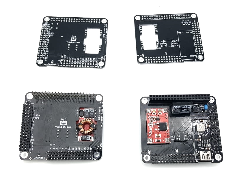

3 : Soldering
We have provided enough black breakawable header (3 of each) to cut so that you can solder all of the hat connectors.
Cutting proposal for assembly :
Header 1 : 16 + 15 + 3 + 3 + 3
Header 2 : 15 + 14 + 3 + 3 + 3 + 2
Header 3 : 14 + 14  + 4 (8 left)
Tips for soldering components:
1) Cut your breakable header to the right dimensions using a fine cutting pliers or break the bar using two flat pliers.
2) Solder the breakable headers, (be careful to put them on the right side of the PCB) check twice the picture below
3) Solder the charger the battery gauge and the step up (be careful on the side where you put them ... they go on the oposite side of the headers, follow the written indications on the pcb )
4) Solder the 2 * 20 connector.
5) Finally solder the capacitors.
Warning, the chemical capacitor is a polarized component, it is important to solder it in the correct direction. The tab - is indicated on the capacitor and on the PCB.
Note: When you solder the header first weld the two pins of the ends and check that the bar is perfectly in place before soldering all the other pins. This will make it easier to correct a possible positioning defect.
UPS hat conventionally welded with only black header, top and bottom with and without components:

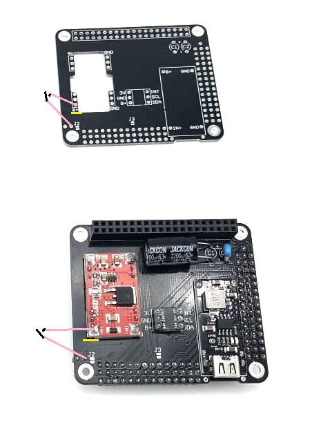

6 : Hacking the UPS to add a switch (optional):
The robot being planned for a H24 use, it was not planned to put a switch to it, but that having been requested by the users we propose the following hack allowing to add a switch to turn off the robot while allowing the charge of the latter, thus facilitating the "resurrection of a robot" which would have run out of battery.
For those who wish, it is therefore necessary to execute the following operation (seen with and without the components)
In yellow a a trace is cut.
In pink two wires leading to a switch.
Warning, in this case choose a switch capable of supporting 3A.
