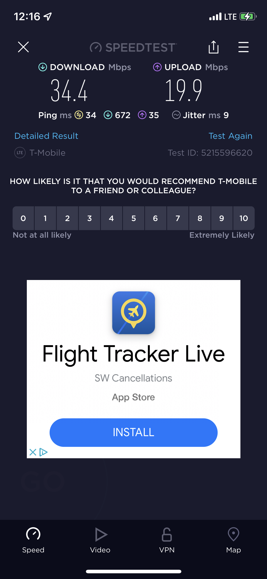

@fire_ned i was correct. this is sufficient right?

i don't know
is that what you use or so far only WiFi?

that's my LTE, my wifi at home is plenty for vigibot

i meant did you already drive around with this connection and it was sufficient?
only reference i have is that aerialer LTE with a ISP spec'ed "10Mbit/s" connection.
20Mbps could be enough, i don't really know

no. i used the phones hotspot but hotspot is always a lot slower and that didn't work

hm hotspot should work. briecam (when not at home) uses a hotspot modem and wifi to connect
