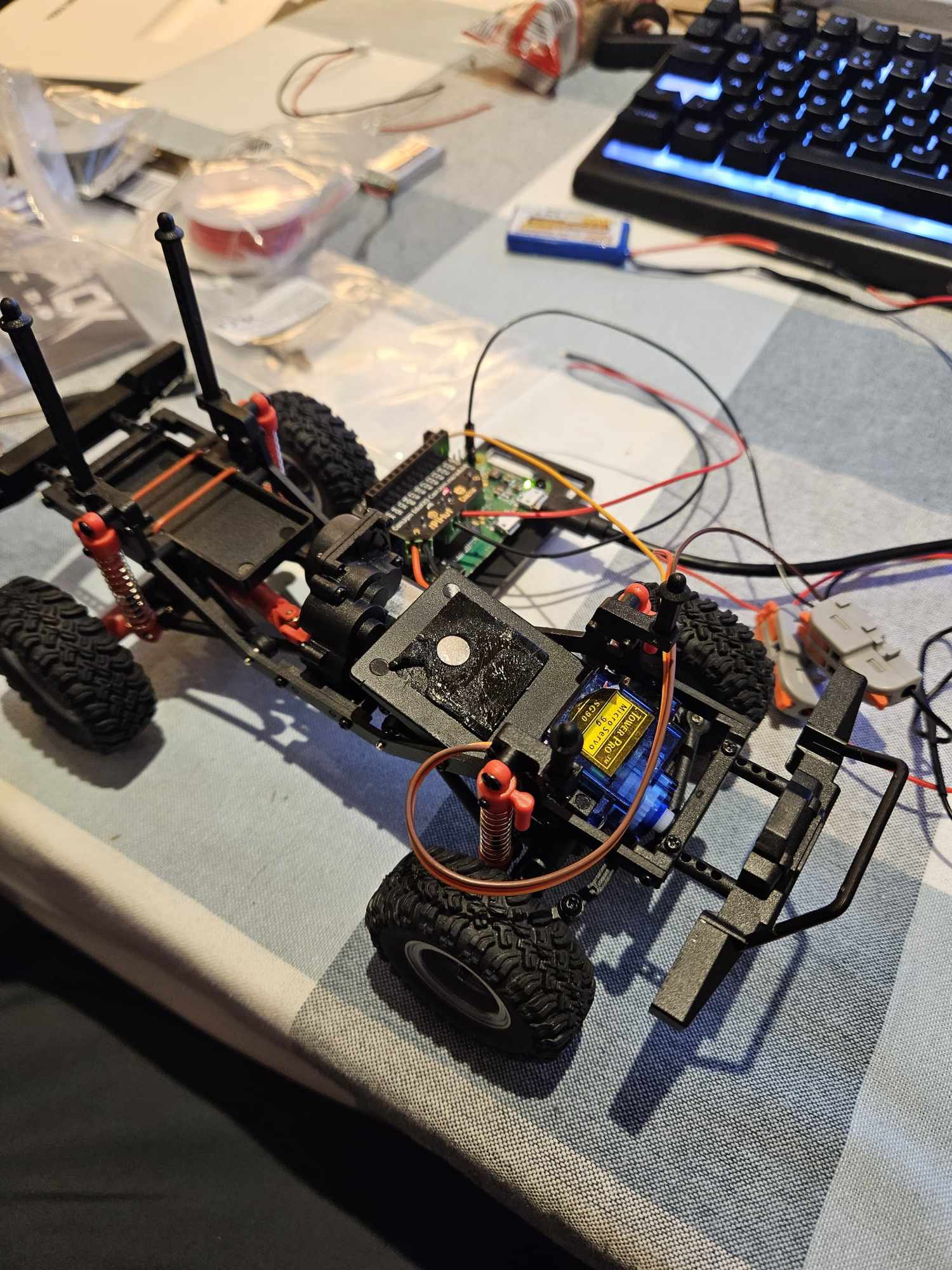

Ok, new platform. An RC crawler for really good torque from 3.7v
It will have a 3-wire micro servo for steering (controlled directly by RPi GPIO 12 and powered direct from the battery). The drive motor will be through a DRV8833 H-Bridge. Is this possible to be configured on Vigibot? 359259567_962011338283356_3014282002676733705_n.jpg

Does anyone know the right configuration for the drive motor? It's a single DC motor through a DRV8833 H-Bridge, on GPIO pins 7 and 8

Oh if GPIO 8 is reserved, I could use 9 and 10 instead?

Posté 09 juillet 2023 - 05:45
Ok, drive motor is working but because I replaced 'left wheels' and deleted 'right wheels', the mixing means that if I input a command to turn at the same time as full forward, the drive is reduced. I believe this needs fixed through the COMMANDS8/16 and GAINS8/16 but I have no idea how to fix this. Does anyone know?

Posté 09 juillet 2023 - 09:34
Hello, this may help you https://www.robot-ma...ds/#entry115626 and you can always check what was your initial config
@Eidyn if you need more help feel free to ask I will help you.

Posté 10 juillet 2023 - 08:51
Ah perfect, thank you so much!
