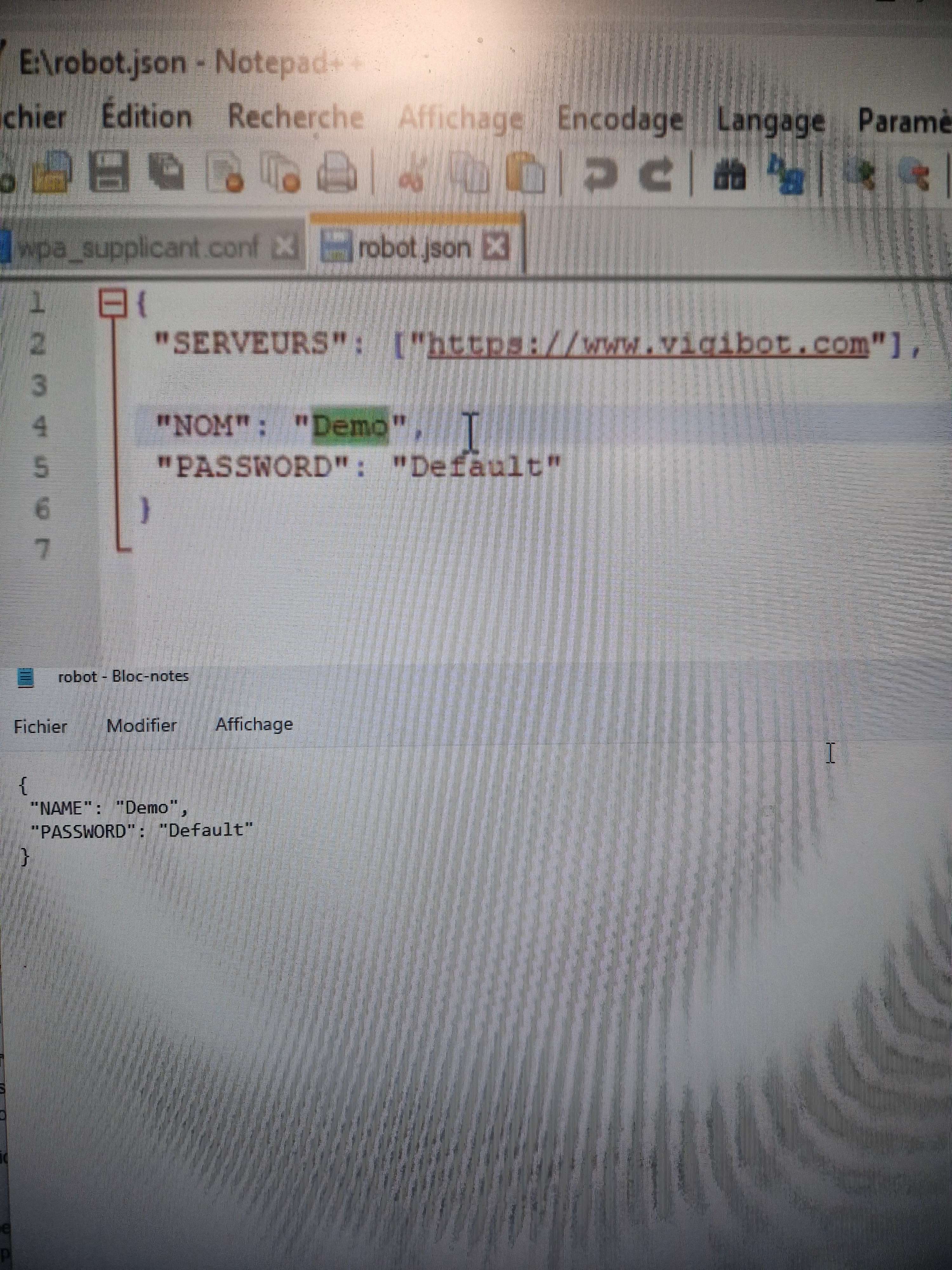

Thanks ! I am following the video and before redo all process I spoted à difference between robot. Json of the video and robot file on vigimage:

Posté 04 janvier 2023 - 09:48
the bottom one is correct :yes:, serveurs is not required.

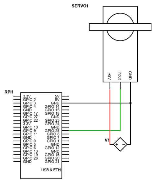

Hi, is there a way to plug servo on Raspberry to benefit of turret function ?
#9550 firened

Posté 21 janvier 2023 - 09:19
yes it's possible.

#9552 firened
firened
  • 1 784 messages
Posté 22 janvier 2023 - 01:53
servos have to be powered from a different power source than the raspberry pi, else the pi will crash often.
similar to this

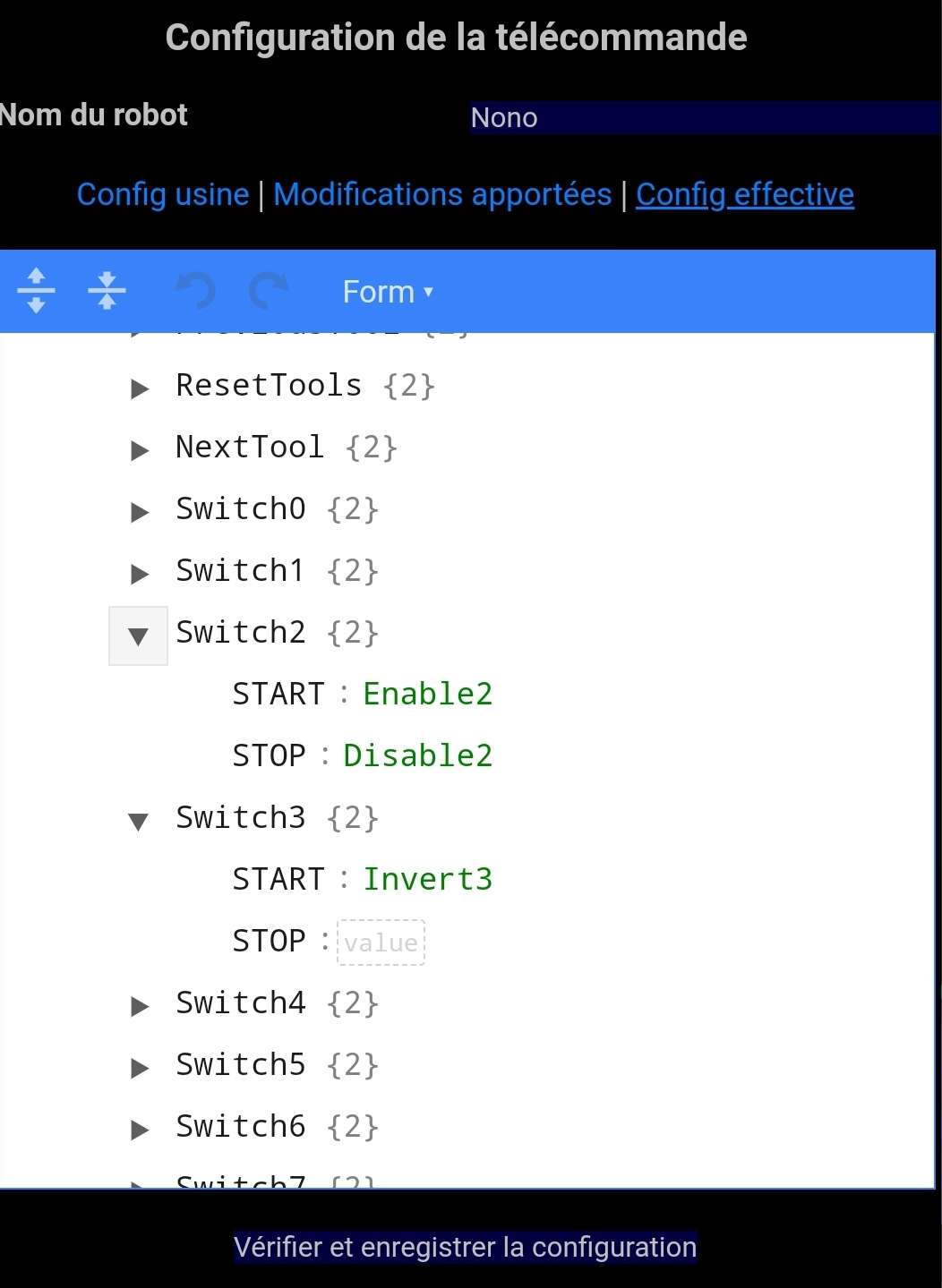

i have an led diode attached to my robot and it works fine when i push the button on vigibot. i wanna have it flash and not be steady, can i do this just through the configuration?
#9555 Mike118
  • 12 511 messages
Posté 25 février 2023 - 10:56
Yes check the switch you want ro modify in the remote config and modify START and STOP in order to add EnableX and DisableX
