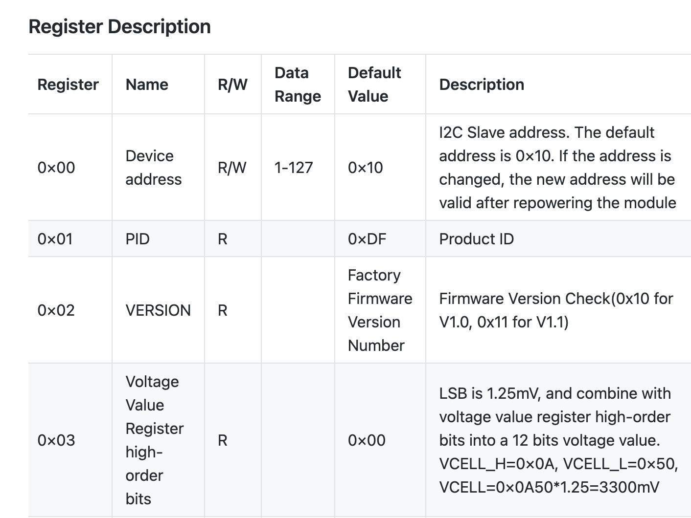

Got this up and running now. How can I configure it for I2C connection to read battery voltage for Vigibot? Do I have to manually enable I2C first? https://wiki.dfrobot...o SKU: DFR0528

I believe the I2C address is 0×10 and the fuel gauge is MAX17043

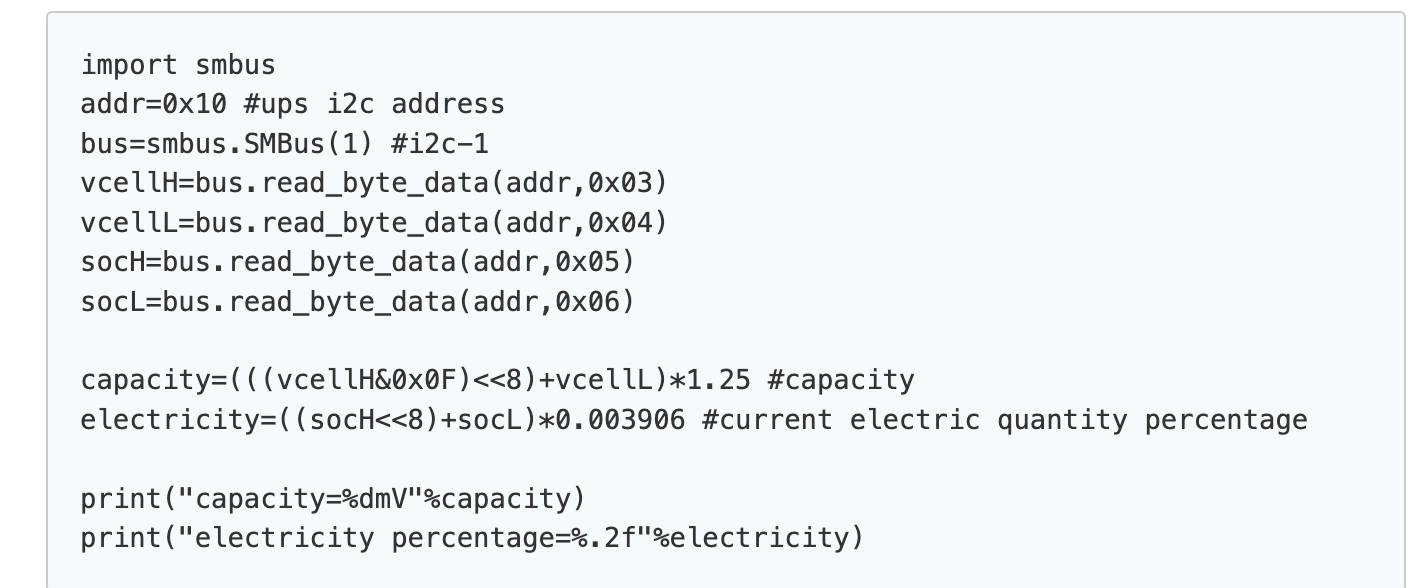

Still no luck. When trying to run the above code directly, it cannot find the smbus module. Does Vigibot use / need smbus for this to work?

Ok first thing : try to have your ups working without vigibot. Then show me the code used and I will compare with the default vigibot code.
#9590 eidyn
eidyn
  • 55 messages
Posté 16 juillet 2023 - 03:29
I believe this is the working code ^^ but it requires smbus. Would it be ok to run sudo apt-get install python-smbus in the terminal on the RPi with the Vigiclient installed?

Ok, I can confirm that that code does now work after installing smbus
But still not showing in Vigibot

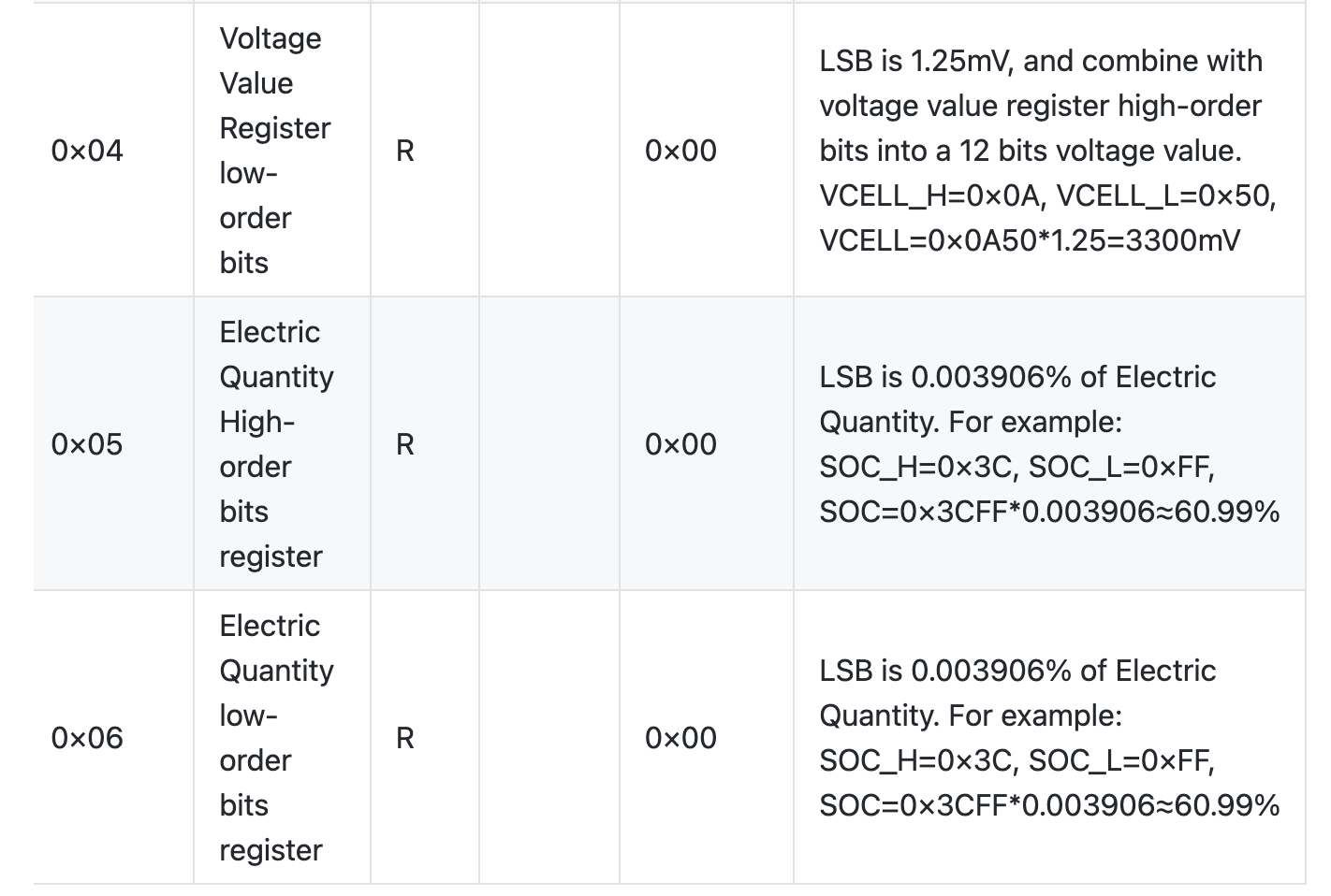

I have unhidden the 'Battery' option and now I have the bar, but it only shows 100% and the voltage only shows 2.5v
In the code above, what gets printed as 'capacity' is actually voltage in mV and 'electricity percentage' is the %SoC
