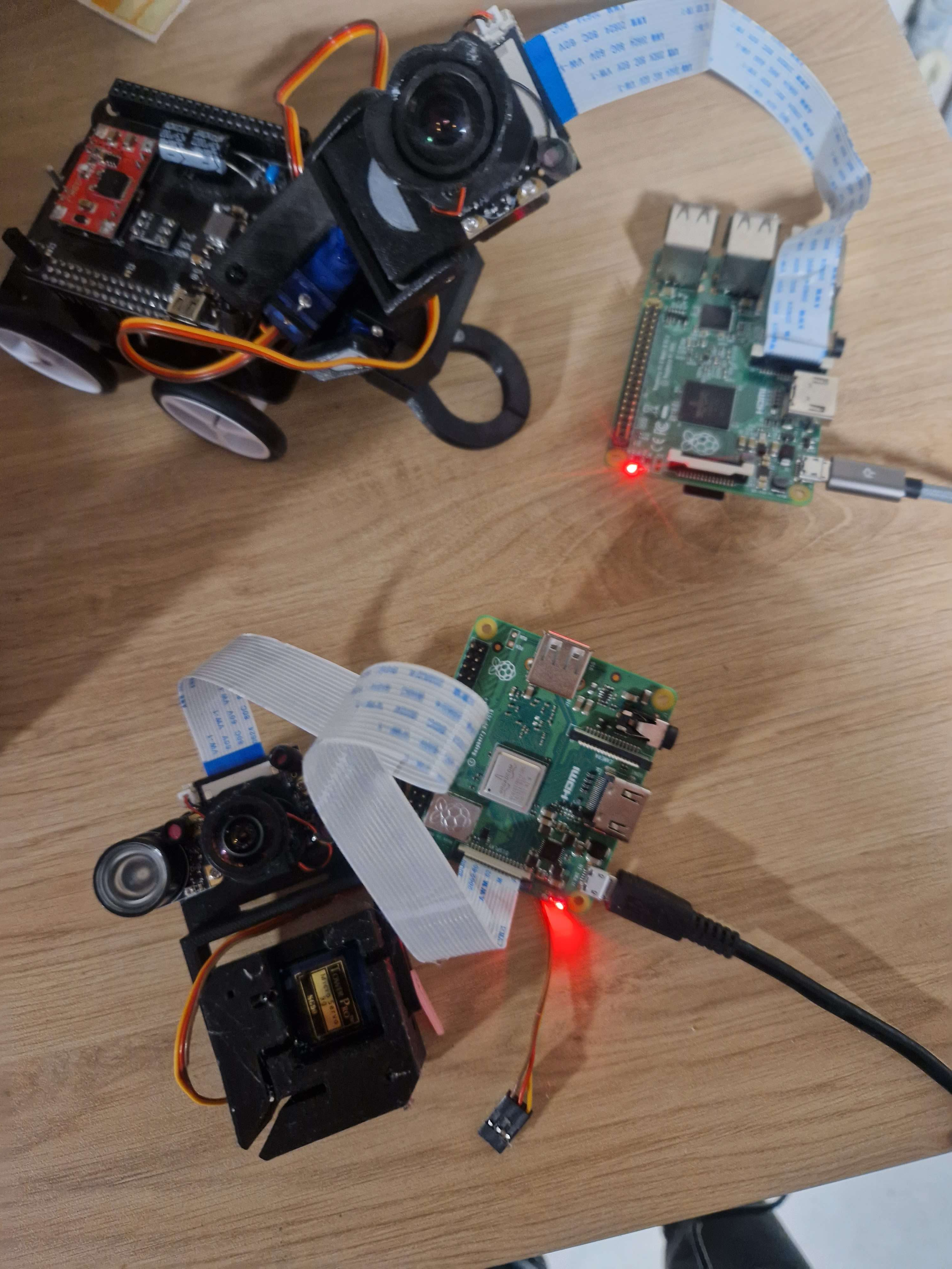

Hi team, I tried to restart my vigibot. I downlaoded vigimage from Web site, create 2 New robots and nothing happen on vigibot. Com
#9539 Mike118
  • 12 511 messages
Posté 04 janvier 2023 - 06:26
99% of the time in such case the problem is that either wifi ssid / wifi password or robot name / robot pasword is not set properly...
#9540 _lartishow
_lartishow
  • 134 messages
Posté 04 janvier 2023 - 06:30
OK thanks, I will redo the process.
