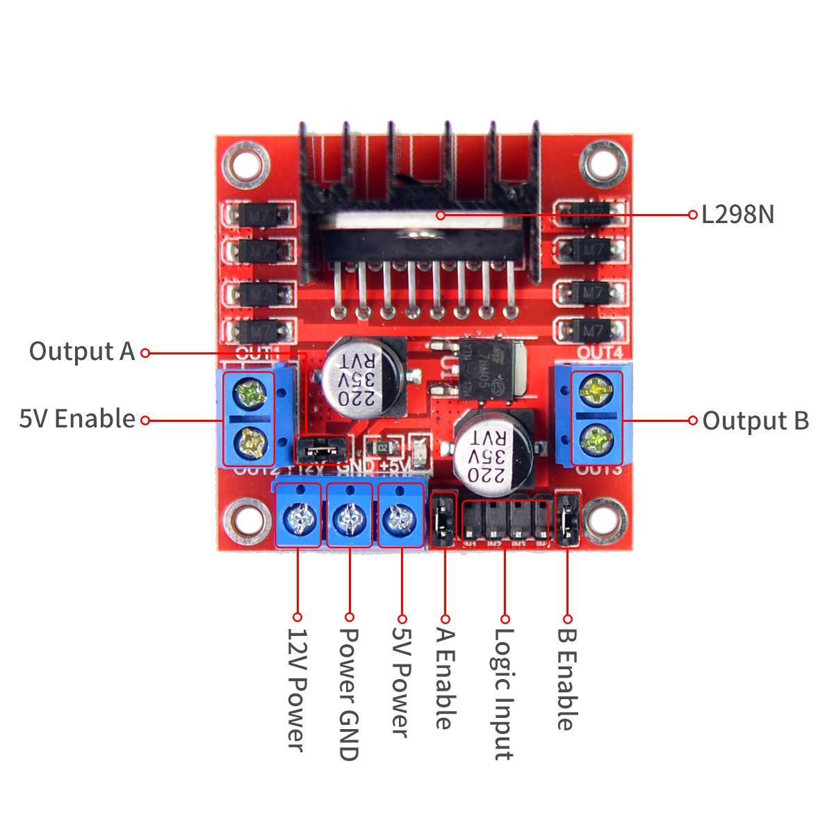

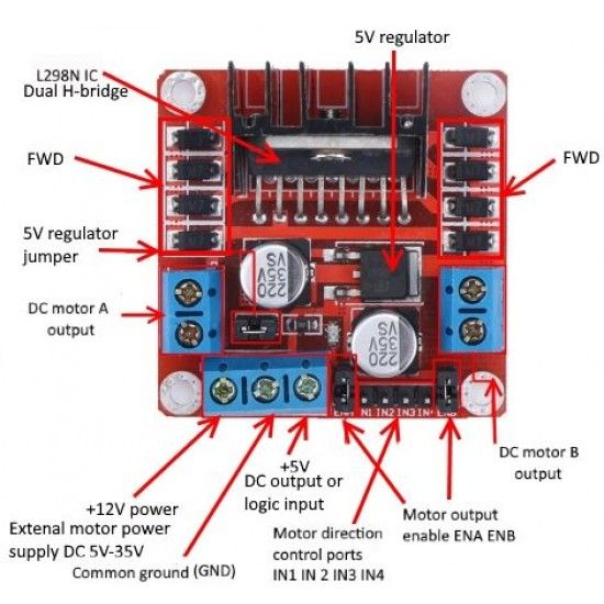

Okay i will try it now.
It's not moving. Is there something else I need to do?
#10382 Mike118
  • 12 511 messages
Posté 05 janvier 2026 - 10:15
This is strange. And if you try the yellow arrow now ?
#10383 firened
firened
  • 1 784 messages
Posté 05 janvier 2026 - 10:53
I think you are missing the 12V motor power?
The 5V input is probably for the logic only
Ah i see there's a "5V Enable" jumper, which is missing in your photo. Can you add a jumper if you don't want to use 12 V ?
#10384 Mike118
  • 12 511 messages
Posté 05 janvier 2026 - 10:59
Yes on the picture sent the motor power supply is not connected

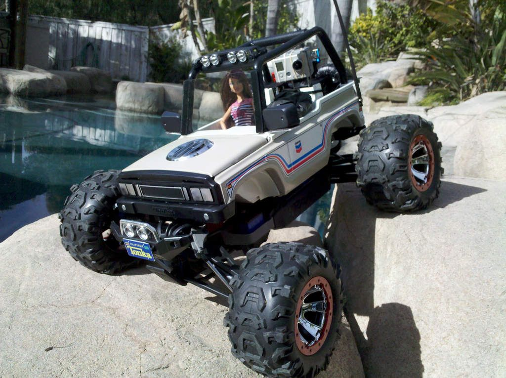

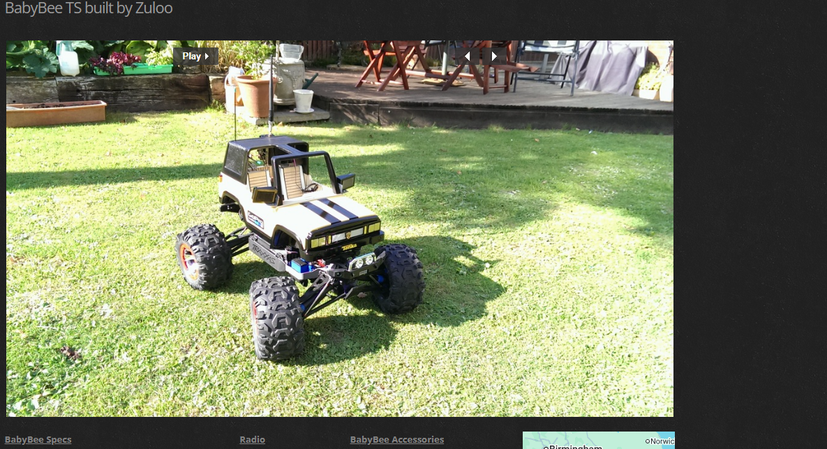

Hello, I might soon be building a Tonka Summit FPV (photo below). Any advice?
#10386 Mike118
  • 12 511 messages
Posté 16 janvier 2026 - 06:57
you can list the hardware included in this car and we can tell you what you should add / connect. But one advice : Don't rush it. Take your time to fully understand what you do and set things properly to avoid breaking anything?

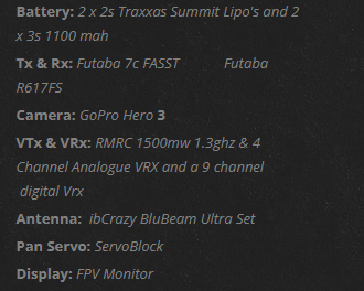

Here is the list to make this vehicle
