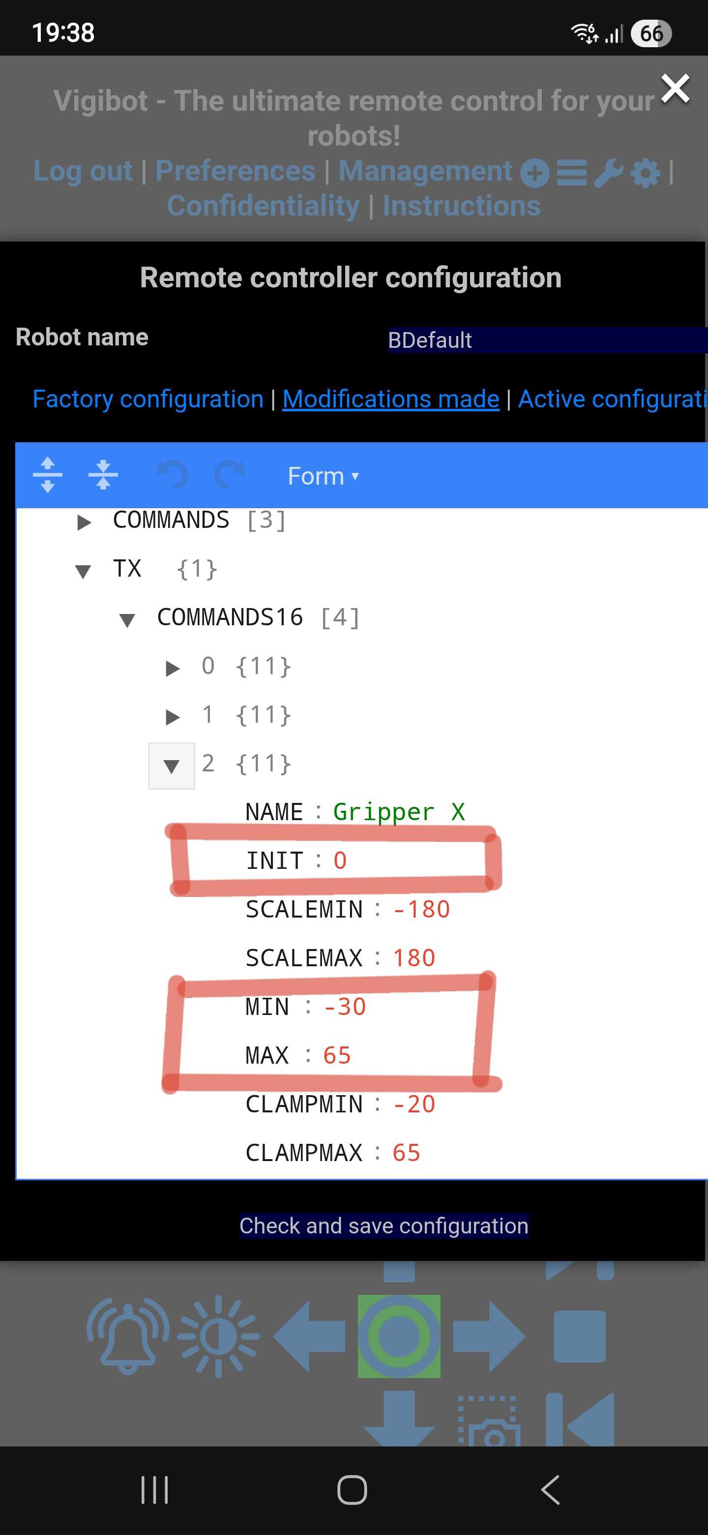

On https://www.robot-ma...ipper-assembly/ I find this sentence about the servos:
" (Any angular defect less than one notch of the servomotor shaft position can be corrected later on the site.) "
With which value can this offset be correctet? Is this the backslash value?
#10422 firened
firened
  • 1 783 messages
Posté 02 mars 2026 - 07:41
You can offset it by adding or subtracting the same value from the 3 entries `init, min, max` :yes:

The issue I tried to solve: there was a gap between the gripper fingers. I solved it by changing in the remote controller configuration
COMMANDS16[2 = "Gripper X"] -> MIN from "-30" to "-42". What would you recommend to solve the issue? I'm happy to try whatever you suggest.
