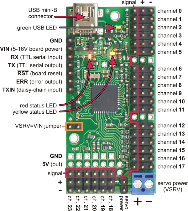

La programmation du module maestro : https://www.pololu.com/docs/0J40/6
Punaise, c'est lourd !!
Le guide : https://www.pololu.com/docs/0J40
La réponse à la question de la puissance :
"Servo power connections are provided in the lower right corner of the Mini Maestro board. On the Mini Maestro 18 and 24, you can make servo power connections via a 2-pin terminal block or a 2-pin 0.1″ header; the Mini Maestro 12 only has a 2-pin 0.1″ header for connecting servo power. Servo power is passed directly to the servos without going through a regulator, so the only restrictions on your servo power supply are that it must be within the operating range of your servos and provide enough current for your application. Please consult the datasheets for your servos to determine an appropriate servo power source, and note that a ballpark figure for the current draw of an average straining servo is 1 A."

Bon, il est clair que la carte adafruit risque fort de ne pas supporter les 12 servos. Il m'est donc conseillé de connecter directement l'alimentation de puissance sur les pin + et - de la connectique des servomoteurs.....C'est d'ailleur la même méthode qui est indiquée sur la carte maestro :
