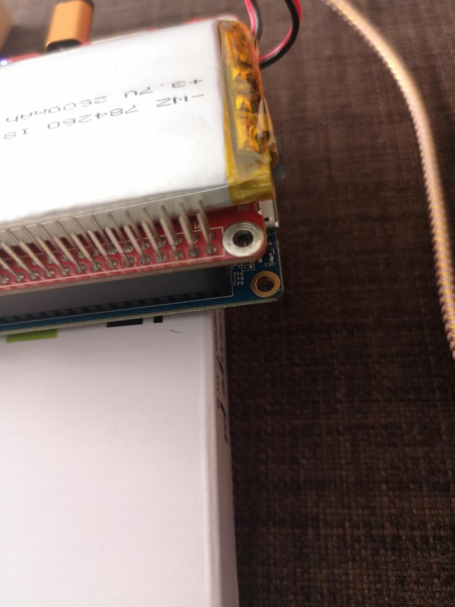

UPS 40-pin hats fit and are electronically compatible, but the mounting holes do not align!
