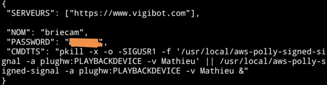

please note that the following app connects to amazon using my access keys. a decent amount of requests are included so feel free to use it for your robot or your other raspberry projects. if you wish to use your own credentials, check out the GitHub repo, which describes the node source code without any access keys:
https://github.com/e...nment/aws-polly
to use the pre-authenticated executable:
1) because i can't put my access keys public, you will have to send me a PM or discord @firened#1228 .
2) add permission
sudo chmod +x /usr/local/aws-polly-signed-signal
3) install dependency
sudo apt install mpg123
4) edit your robot.json file
sudo nano /boot/robot.json
and add
,"CMDTTS":"pkill -x -o -SIGUSR1 -f '/usr/local/aws-polly-signed-signal -a plughw:PLAYBACKDEVICE -m -v Mathieu' || /usr/local/aws-polly-signed-signal -a plughw:PLAYBACKDEVICE -m -v Mathieu &"
it should then look like this:
to use a different voice, replace "Mathieu" twice in your robot.json file with a different voice-id.
