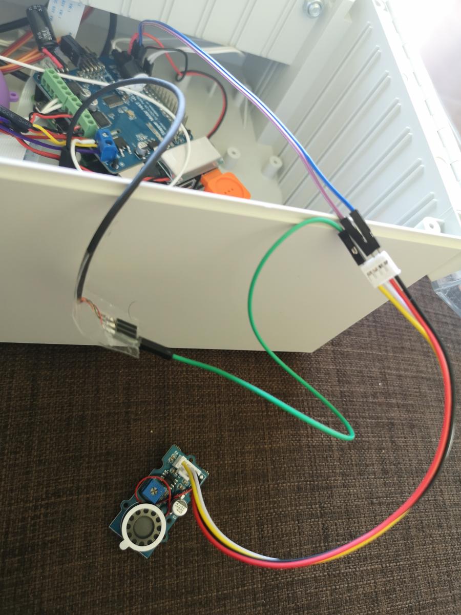

groove speaker
very small speaker. audio quality is very quiet, about the volume of small headphones, any louder causes significant clipping. maybe using a bigger speaker with this board could improve the volume.

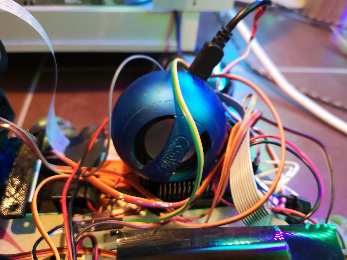

X-mini brand speaker
pretty large speaker. audio quality is great. volume can be adjusted precisely. that's my favorite speaker so far.

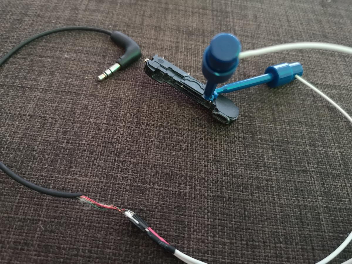

smartphone speaker without amplifier
way too quiet.

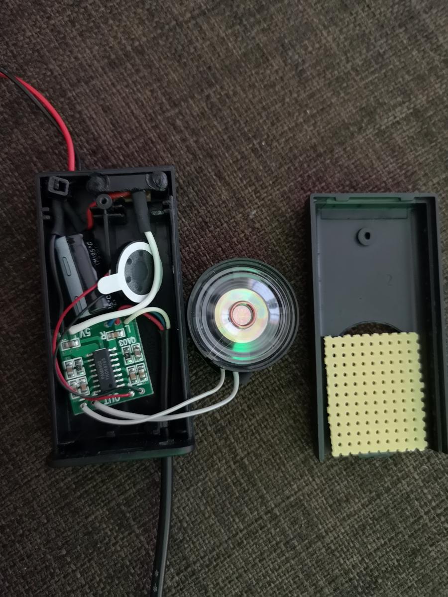

filterless PAM8403 with plastic 0.25W speaker
sounds very bad. it probably sounds bad because of the crappy plastic speaker. other people had success with the PAM8403 module.

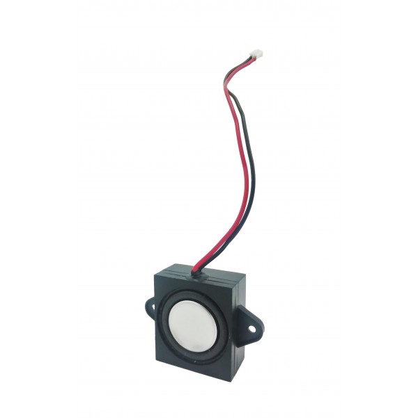

One well working solution :
Speaker : https://www.robot-ma...leur-d-421.html
Combined with amplifier : https://www.robot-ma...dio-5v-420.html
Use the 5V GND from the pi to power the amplifier board on the 5V + -
Connect  a jack connector to the L Neutre R pads.
Connect speaker(s) to the L and / or R Out pads.

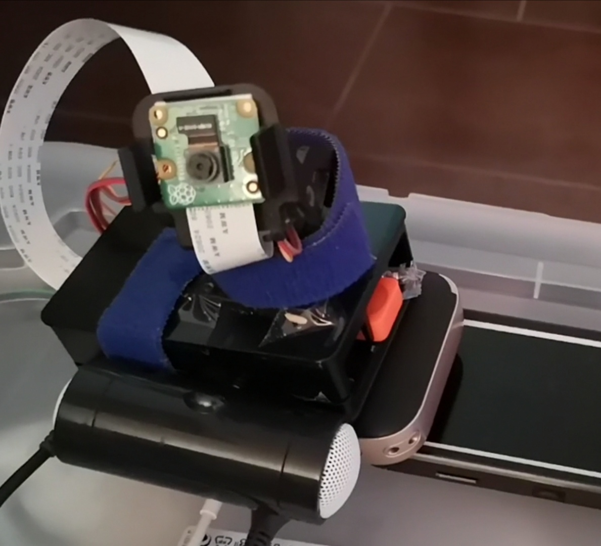

bluetooth speakers
unfortunately I can't configure the bluetooth speakers correctly on rasbian. it's a shame as they are the perfect size with loud volume for a minus sized robot.
there are different audio profiles when using bluetooth devices. "SCO" is low quality voice which makes it hard to understand the TTS, unfortunately i haven't figured out how to switch to the "A2DP" high quality profile. if anyone has success, let me know.

it also cuts off the start of audio when waking the speakers from sleep, i do not know whether that would still happen with A2DP or not.

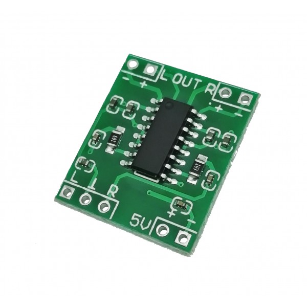

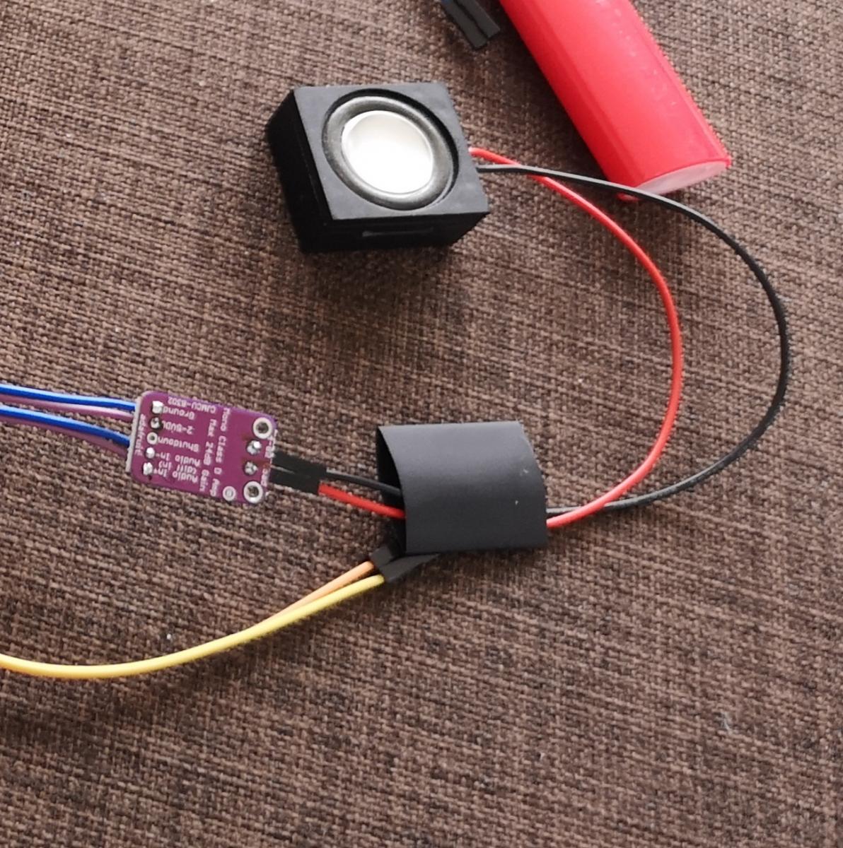

PAM8302 amplifier and 3W rectangular speaker
this combination yields an impressive result! i really like the strong, well understandable sound this speaker creates. i use a FET connected to a GPIO to turn off power the PAM amplifier completely, as it does create some quiet static noise.
https://a.aliexpress.com/_B0mjYE
(i used a single channel PAM amplifier, but the double channel should give the same result https://www.robot-ma...dio-5v-420.html )

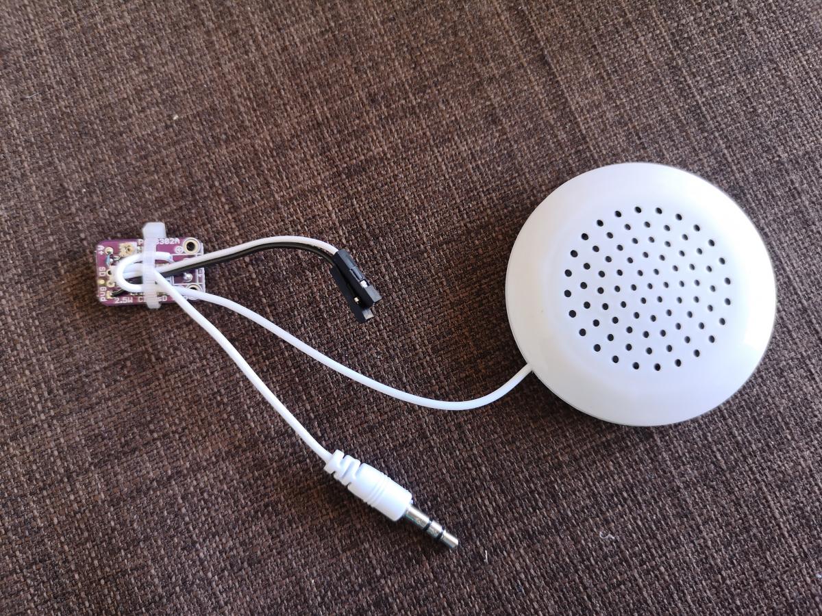

PAM8302 amplifier and cheap white flat speaker
this combination sounds ok, but the cheap speaker has high trebble and low bass, making the overall sound quality less appealing. i use a FET connected to a GPIO to turn off power the PAM amplifier completely, as it does create some quiet static noise.
https://a.aliexpress.com/_BSyPty

X-mini brand speaker on a usb sound card
pretty large speaker. audio quality is great. volume can be adjusted precisely. the usb sound card causes a 'click' at the end of each playback. i assume it must be software related as i tried 2 different usb sound cards, but it's only a small annoyance.
