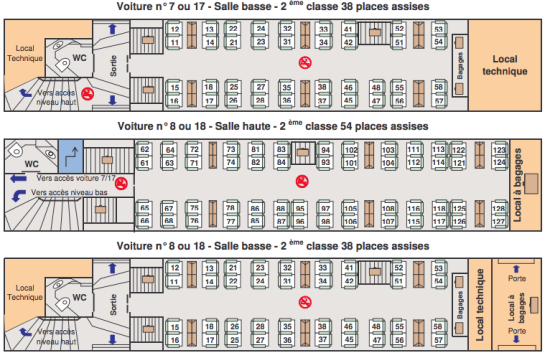

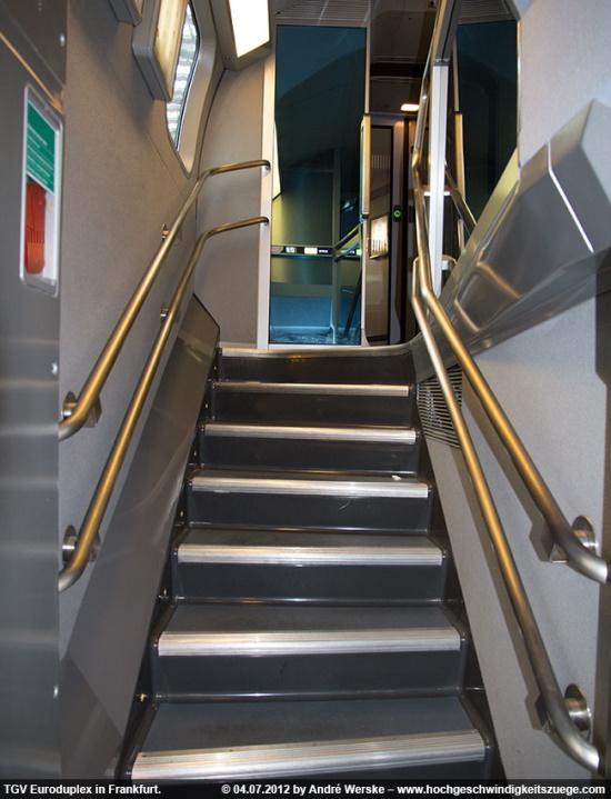

Yes, it is a good idea to make a tank for climbing stairs, but I have to know if the stairs have nose.
Here a few pictures to help talking.
NoNosingStairs.png NosingStairs.png TGV couloir.jpg tgv-euroduplex-ffm-03-gr.jpg Plan TGV INOUI.png

Some steps have noses and others don't, it depends on the convoy and not all the steps of the ladder are the same.
Thanks for de pictures, the first time I don't had  understand (if stairs have nose or not).

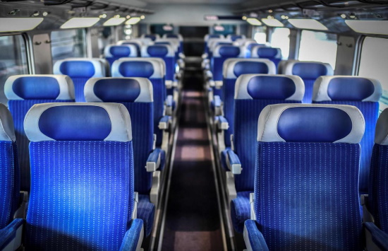

Here som pictures about kind of trains that we have.
118_4pag.jpg116_1pag.jpg_51_853bf0ce.jpg?31af3da7c7c28ec3436795f9669578687_02537fdb3f_z.jpg

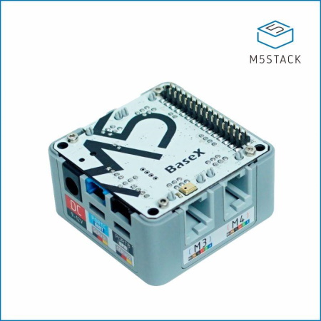

You told me that you want to use an ESP32. May be you know the M5Stack which contains an ESP32.
The good thing is that with an M5Stack you can use a shield for big Lego servo. Those are clever servo, they can go to an angle of course, but they can too run to continuous rotation. You can too order it to do a number of turns. What else, it can be used as an angle sensor.
I have a few M5Stack, wich I never succes to connect, but I am a dummy . . .
Anyway, I think this could be a good way for your project.

I have been looking at the M5Stack module and it is true that it is very well equipped to work with motors easily, anyway I think the control of the motors it allows is like the typical stepper motors.  But thanks for this discovery.
I had thought with the ESP32 for the number of I/O it has and because it is faster / more powerful than the typical Arduino because in the end the number of sensors and actuators is significant.

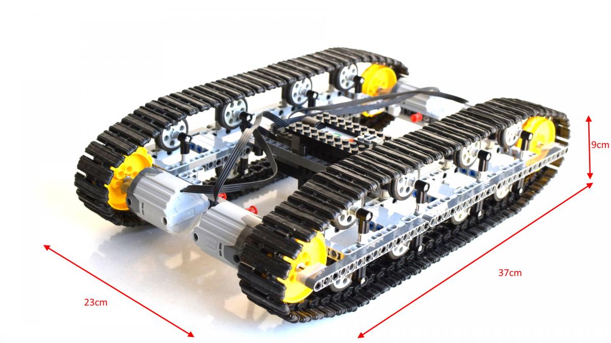

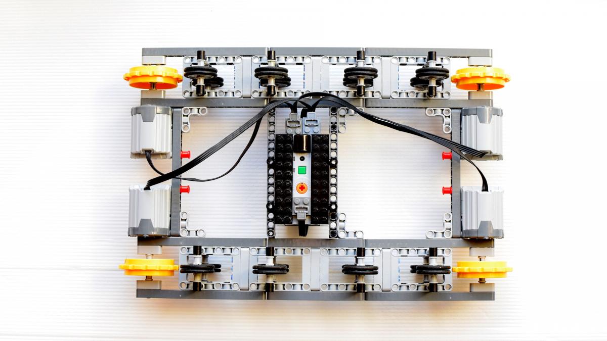

This morning, I made this tank. It has 4 motors, but 2 are sufficient. The tracks are home made, Lego track and ruber sticked.
If you like it, I make the BOM.
Click me :
